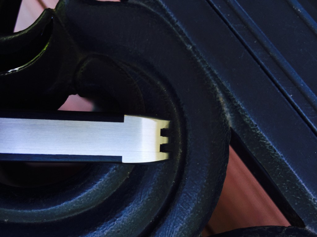

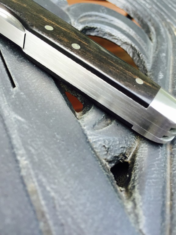

I'm wondering because I marvel at how close the tolerances are on the springs/liners. 5 pieces of steel stacked up here, and looks like one. (sorry, Cell Phone pic is all I got!)
Seems to me the blade does not need to be as precise? Still, I'm intrigued that they use it at all!
Thanks for the info.
Eric
(sorry for all the lint on it - It hangs in my pocket every day lately)
Here is a straight on shot:
You can also see the mill relief on the liners - maybe wire cut???
Eric
Eric
Eric
The regular production knives like the trapper and BackPocket they are doing now only the blade is EDM wire cut. On the yearly collab I do with them all the parts are wire cut including the shield and bolsters, liners, blades and springs. I take no offence to this. I know that most people don't understand what goes in to these yearly knives. The cost of producing them is much higher than a regular production knife. It gives somebody a chance to get a piece of me at a fraction of what one from me would cost. These are very good knives, the best Case ever made I think.
