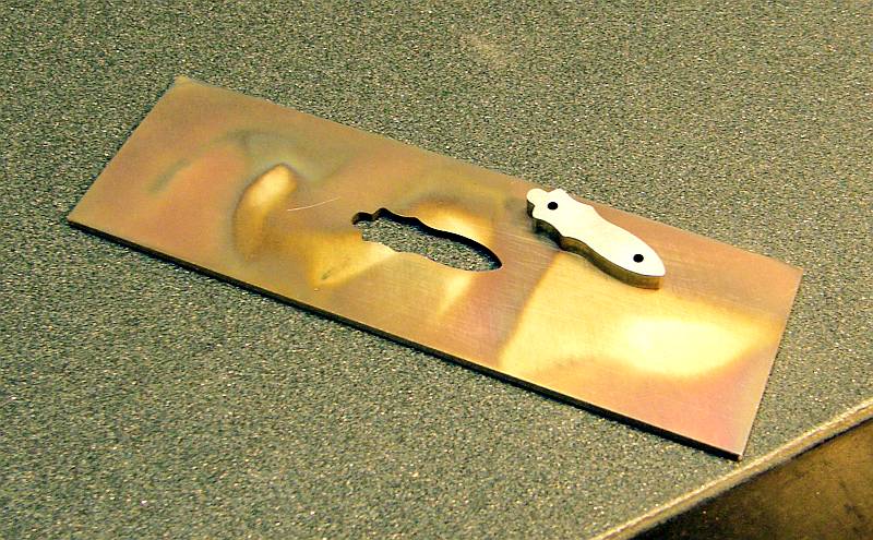

BTW...I was at the WW last night and asked Tony about the shield he put on that knife I just posted. Here is a shot of the parser plate that he would use on smooth handle materials. There is also the shield template that he would use to hand cut a shield from SS sheet. Notice how precise the template fits in the parser plate.
When making a shield from scratch...
1. The little shield template is temporarily clamped with vise grips to a piece of stainless sheet and the holes are drilled thru.
2. A line is scribed around the template onto the SS sheet giving a cutting line that will be used on the band saw.
3. The SS sheet is taken to the band saw and the shield is roughed out up to as close to the line but not going over.
4. Once the shield is roughed out, the template and shield blank is re-pinned, clamped, and the shield is filed around until it matches the hardened template perfectly. The file doesn't cut into the template because it is harder than the file, therefore, you can use the template many times to make several copies of hand made shields.
The biggest issue with symmetrical shields is keeping the symmetry correct. (uhuh...symmetry ain't where people go to their final resting place:rolleyes:)
By using a correctly made template, we can duplicate the correct symmetry every time.

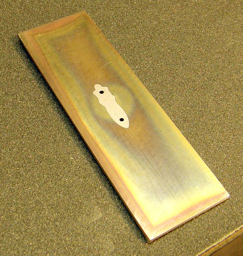

I'm getting it, I think; thanks Kerry. So after making a shield from the template then the parser plate is fastened to the handled "scale", and the recess cut?? I hope my terminology is correct.
You got it. :thumbup::cool:
This is probably the wrong place to ask this, and as a newb, I don't want to get hollered at ( :foot: mods, just delete me ), but, how do you position, hold in place the parser plate, and determine how deep to cut ?
Flat plate on a curved cover...hard to see your work ?
Fran
Fran
Centering lines are placed on the handle to align the plate and the two are clamped together onto a flat plate. The plate with the handle and parser plate are positioned with a 1/32" end mill mounted in a vertical milling machine. The end mill is lowered gradually into the opening of the parser plate and the handle piece is moved around by hand to cut the material that is accessed thru the parser plate.
