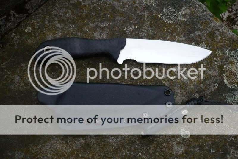

I did a stripping and thinning and a high convex grind on this SJTAC and it works brilliantly for bushcraft...it is my sharpest Busse and possibly my sharpest knife....
I gave the edge a bit of extra height by the handle for more delicate tasks and having convexed it ... it is still very strong and does not "roll" when working on hard wood...for strength near the tip I gradually tapered the edge so that it is still plenty sharp but strong enough for chopping and batoning or rawling holes using the tip...this knife works as well as any and probably for a lot longer than the scandi bushcrafters with zero edges and even those which have a proper micro bevel...
