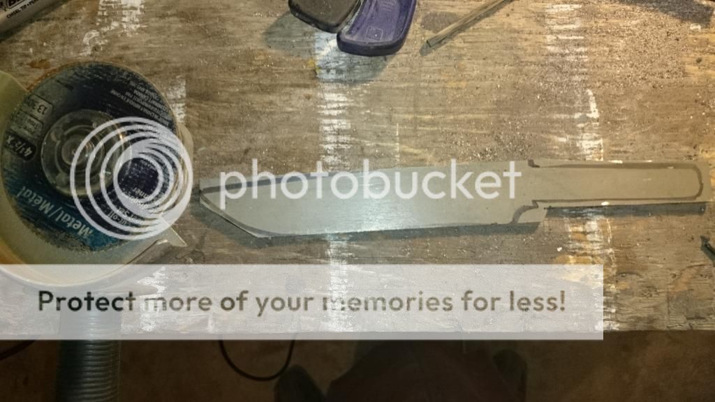

I made some progress today. I'm always happy to get some shop time.

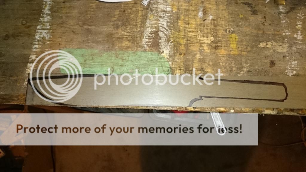

First I cut out the template and traced it onto some 5/32" 1084.
Then it's time to suit up!
I wish I had a band saw, but all I have is an angle grinder. I find it much easier to use now that I have the thin cutoff discs.
Then the rough profile with a 36 grit blaze belt.

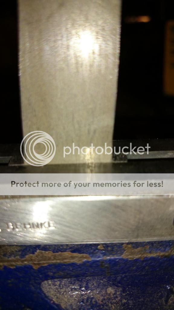

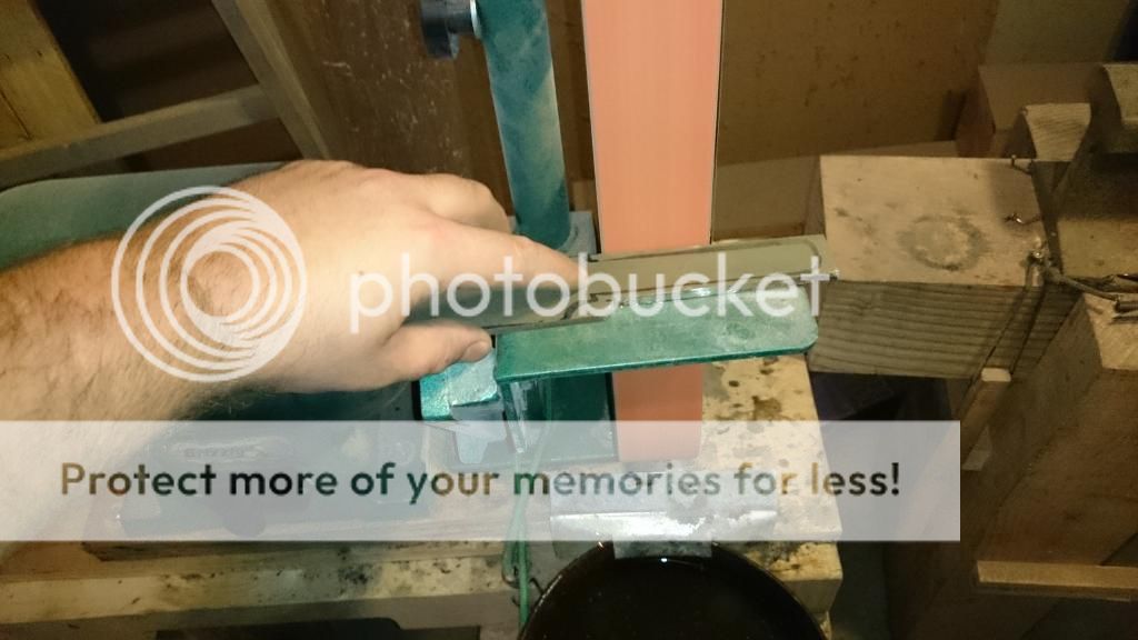

After getting in to the general shape I am going to use my carbide file guide to square up the shoulders. I got this file guide from Bill Behnke. It works great, and Bill was a great guy to deal with.

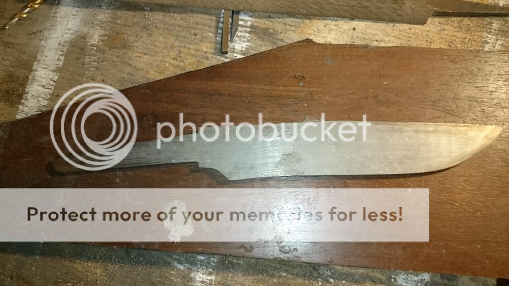

Here's the rough profile. I have some refining to do like tapering the tang slightly and I may make the recurve slightly more pronounced.

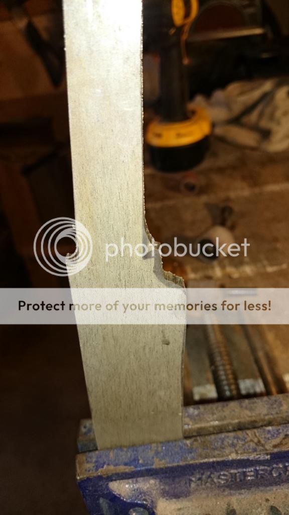

IMHO, you will get THE best guard fit if you wait until the blade is heat-treated and nearly at its final finish before doing a final cut-in for the guard shoulders. Nothing wrong with cutting them in now, but I highly recommend your touch them up before fitting your guard.
Also, while I applaud you for going with a beefy tang and avoiding the pencil neck tang so many fellas usually opt for ;) you can taper it more towards the ass end. You'll still have plenty of meat/strength/weight (for balance) but you'll have to hog out less handle material at the rear of the hole--- less broach work and less chance of grinding/filing into your tang cavity while shaping.

Here's my plan for tomorrow. Clean up the bottom of the ricasso area. I just don't like the shape right now. Taper the tang towards the "ass end" so it's not so meaty :D Nick

I really need to get one of those file guide things!

I notice the belly is lower than the edge at the heel. I'm sure there is a technical term for this but I have no idea what it is.
I ask because I like that style, I ground my first knife like that unintentionally and my pops pointed out how he liked it. Never really noticed much until then but I do like the look of it. So just curious what your thoughts are behind it. Based on the overall arc of the blank it looks like it would function a bit like a kukri!
It's called recurve Augus. I liked the look of it on this blade as it gives it some more curves. A recurve removes some weight from the rear of the blade and shifts it towards the tip. This can increase chopping power, as with a kukri.

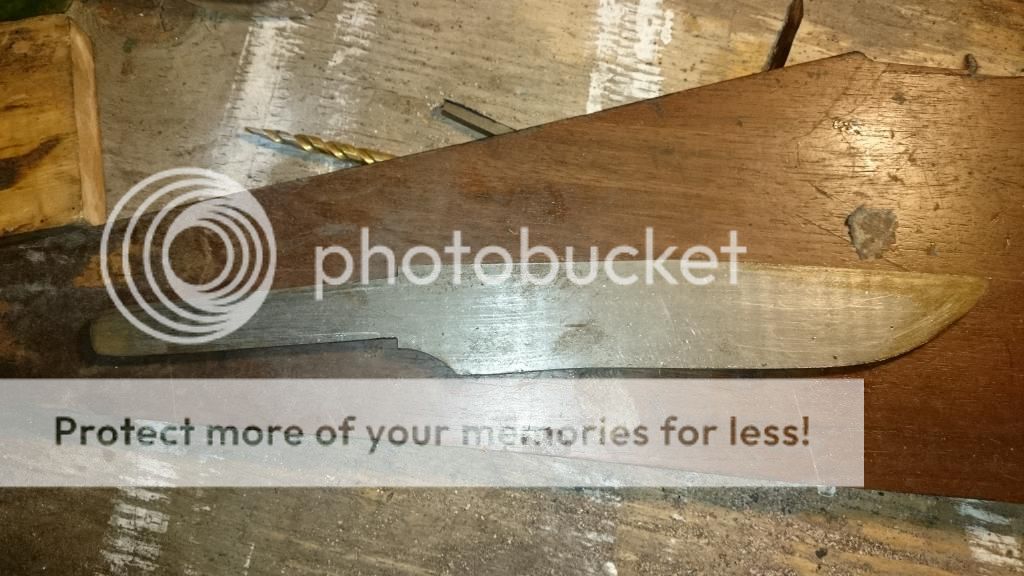

I fixed the profile up today. Tapered the tang more, fixed the bottom of the ricasso, and made the recurve a bit more gradual.
Before I start grinding the bevels I thought I would ask a couple of questions. I've never ground a swedge so I'm a little unsure of the order of operations.
My plan is to grind the main bevels first, full flat grind. Get them to 220 grit, then grind the swedge.
Any tips on grinding the swedge. Or does anyone have a link to a good video on the subject?

Once the blade is hardened, will the file not simply skate over the steel, making the process of squaring the shoulders near impossible? Are you using belts instead of files to do this with the file guide? Forgive me for the simple questions, I am just trying to better understand your process.
Thanks,
Pete
Thanks,
Pete
With the carbon steels, you can(and in my opinion should) either differentially harden or temper the blade so you have a hard edge and a softer spine/ricasso/tang.........file will cut it no problem. That said, most blades are tempered a bit softer than a file anyway, so it'll cut if the file is new and sharp........especially if there isn't too much to take off to tune the shoulders up.
