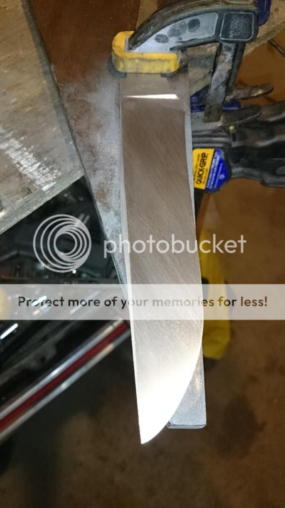

Ok I finally got some more time to work on the bowie today. My real job is really getting in the way here...

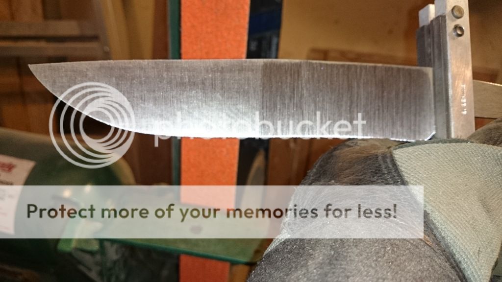

Time to grind the bevels in. Back to the trusty ol' file guide.
I mark the edge with a black sharpie, then scribe it on both sides using a drill bit.
I knocked down the edge with a worn out belt, then on to the 36 grit blaze belt. Here's the first side after 36 grit.
Here's the profile after 220 grit on the belt sander.
I took the edge down to .023 so far. As you can see the plunges are uneven. The plunge lines are actually lined up due to the file guide, but they are uneven at the bottom. I believe this is due to the terrible tracking on my grizzly. The belt gets pushed to the right when I put pressure on them. Oh well, just more hand finishing with files and sandpaper...

One suggestion when rough grinding bevels. Keep the grind a bit lower(away from the spine) until you are on to finer grit belts. Otherwise you will sometimes run out of steel and grind the plunges too high. Your grinds look good, but you will not have much wiggle room for finishing. I typically leave the flats along the spine a bit wide until after heat treat.

Yeah the plunge almost got away from me there and bit the spine. I'll definitely be more cautious next time. I'm all hand sanding from here so I'm in the clear :o

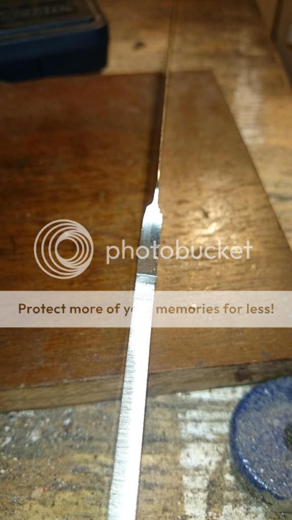

I started cutting in the swedge with my grinder. I found I didn't have enough control. I switched over to a hand filing the swedge. Took more time, but the side I did solely with the file looks better.

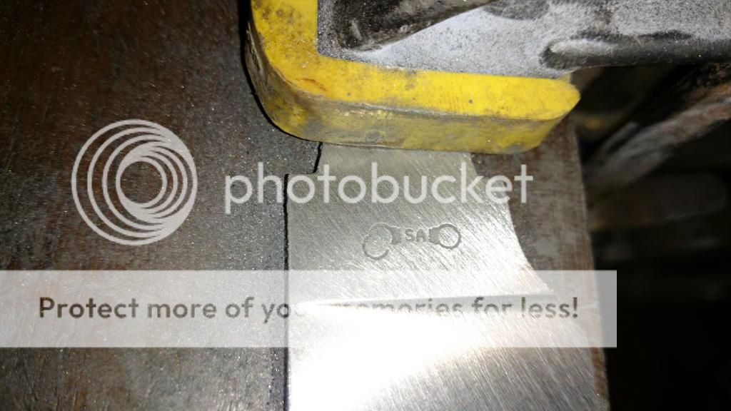

I stamped my makers mark on the ricasso.

With this swedge I'm not getting it anywhere close to sharp. It's a bit different than some knives where they can basically be another sharpened edge.
It will depend on the lines you want for the swedge and the thickness of the spine. With a ffg the tip gets pretty thin. Add another sharpened edge on top and the tip would be too thin IMHO.
AFAIK swedge, swage, clip, and false edge all mean the same thing.

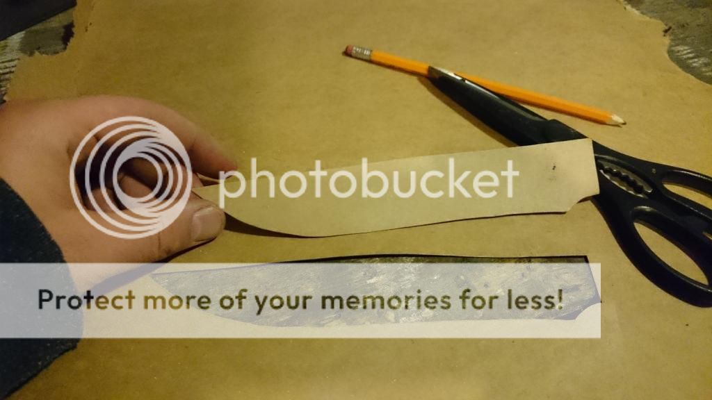

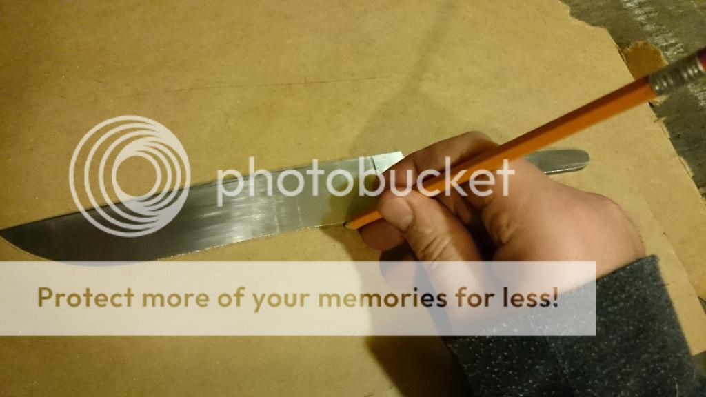

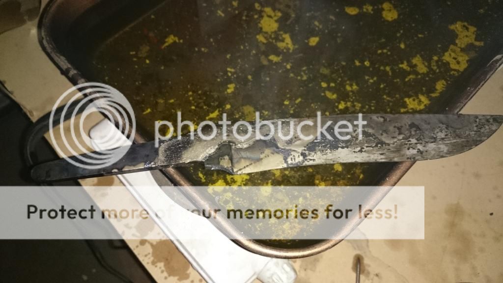

Now I'm getting it ready for the clay coating. I trace the blade out on a piece of cardboard, then cut out the clay shape I want to achieve. I do this to keep the clay relatively even on both sides of the blade.
Then I mix up the satanite and apply it to the first side of the blade. When I'm done the first side I clean off my clay template, flip it over, and apply to the second side.

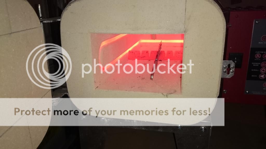

The clay has dried, now to austentize!

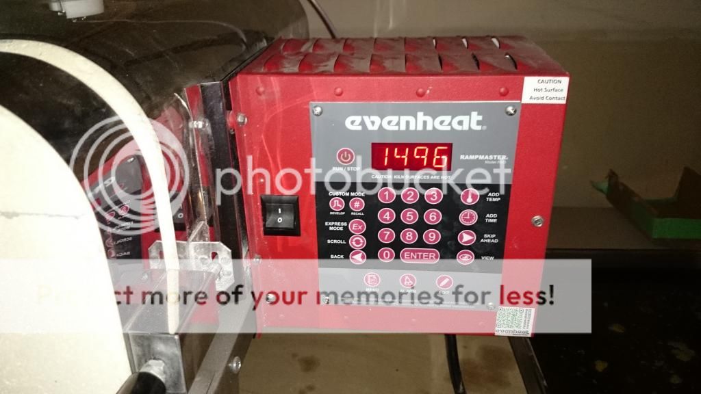

Took it up to 1500 degrees in the ol' evenheat. Quenched in 130 degree canola oil.
After quench I tempered it twice at 425 degrees. Next I'll clean up the tang and draw it back with a torch. Then its down to blade finishing, etch and polish.
