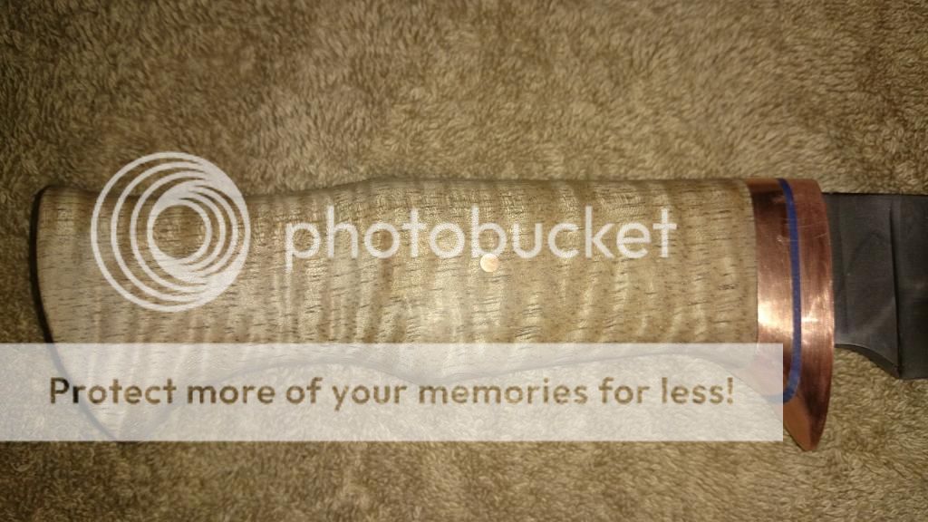

It's almost done. I hand sanded the handle up to 2000 grit

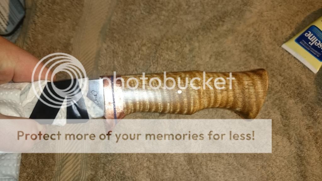

Then its time for some tru oil on the handle. I put some Vaseline on the guard to block the oil from it. Then I rubbed the first layer of tru oil on with my finger. After a quick wipe here it is.
A couple more coats of oil, then sharpening and sheath making.
(Oh, and I do have a real camera:D... I'll take some better shots once the handle is done).
