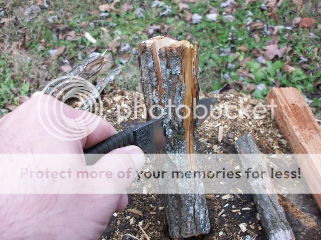

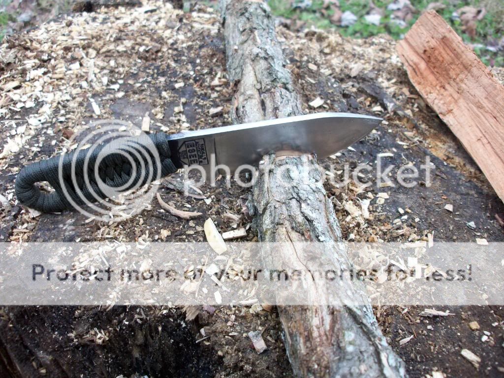

But like I said, batoning is also useful for a multitude of skills in the woods, here I am batoning some willow, to make a bowdrill kit. That's not a big chopper I am using either.

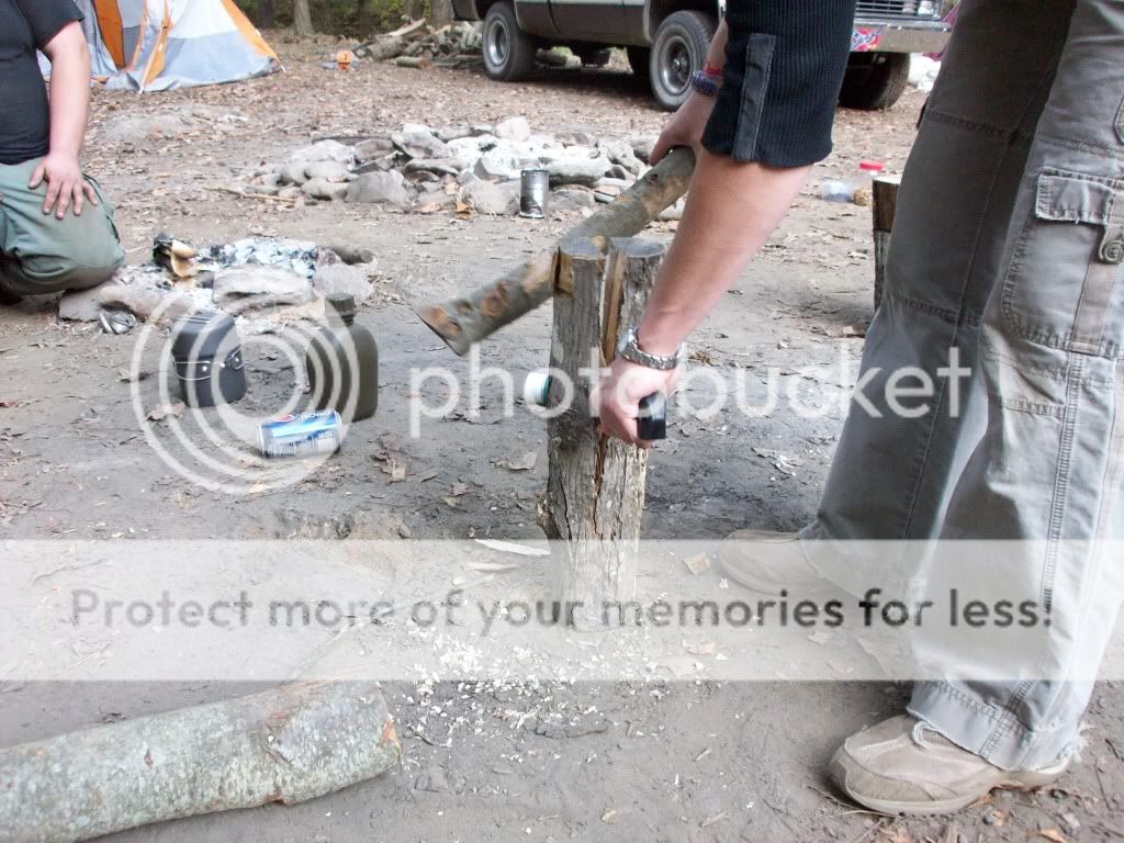

Here's my hot ass wife batoning a BK3 in a competition at one of my gatherings last year. Talk about a knife that was made for it, damn that thing is beast.

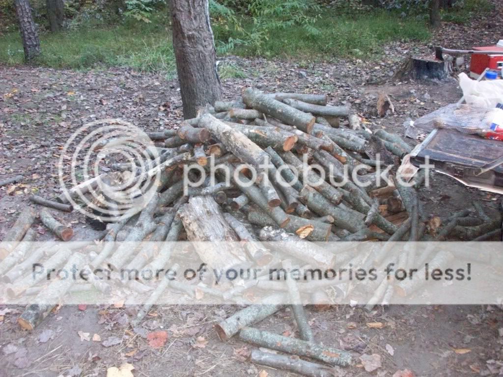

Yes, a little. Notice the axe in the background? Only one guy at my gathering used it. The rest of us used knives. LOL
