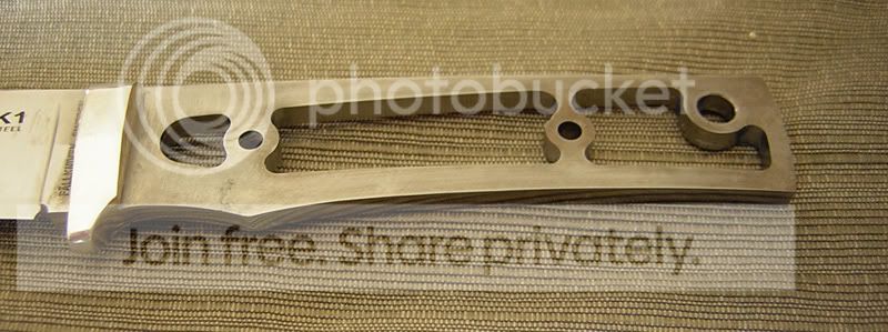

I hope I don't get in trouble asking this here but what do you makers think? There has been some complaints out there over the last few months from some of the users that purchased Spyderco's UK Bushcraft knife and breaking it. I'm refering to the factory seconds, the ones that were having problems with the "stabilized" maple burl. I've read that several people have broken their knife when batoning with it. No I have no broken mine, and yes I have split wood with it. But it was only small pieces. The blade is less than 5 inches so there's not much you can do.
The reason why I'm asking you guys is because I've not seen anyone post this question to knife makers. (If I missed it, sorry!) You guys seem to have the most knowledge on anything technical. It's a full tang knife but the handle is skelotonized. Was that a bad idea on Spyderco's end? Or is that not unheard of? Does a properly made skelotonized knife still not a knife to baton with?
For what its worth, I really like mine so far. It was a steal at $90.
I think it depends a lot on how it is skeletonized. A bunch of holes that line up in a way where you've perforated your part like a perforated stamp and the metal gets really thin in important areas is a bad idea.
I feel that this tang was skeletonized in a way that minimizes risk of failure. One could debate the pros and cons of skeletonizing vs tapering, but either improve the balance of most knives.
I have not seen the spiderco tang. I can say that non functional hole in the blade doesn't look like a great idea.
somewhere there was an article, or blog that batoning incorrectly will break just about any knife. Full tang or hidden tang. I think those who now have broken knives have learned a valuable lesson on what should and should not be done with a knife. Custom or factory.
Is this like the tang in question?
that might be improved by tapering the skeletonizing rather than the uniform thickness throughout. There isn't enough meat near the guard area and the transition is too extreme = stress riser and weak.
... actually, it probably isn't extremely weak, but it could certainly be stronger with a large radius going into the guard area. Minimizing weight in the guard area doesn't improve balance much anyway.
.. my .02...
A full tang knife should not break unless it is significantly bent and a knife designed for bushcraft should be able to take just about any amount of batoning.
I saw a broken Spyderco Bushcrafter and IMHO the holes in the handle were too big and the tang too hard.
Hmm, maybe I described the tang incorrectly. I too remember seeing what the tang looked like on this UK Bushcraft knife. It has large holes drilled into the handle. So maybe saying it was "skeletonized" was a little deceiving. Its more like Swiss cheese.

Nathan, thank you for your input on the design features.

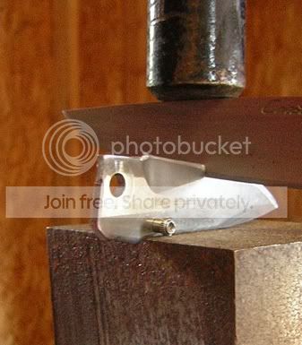

I wish someone would post a picture of the Spyderco that broke while batoning that was recently in the WSS forum.I don't know how.
Regardless of what you think of batoning in general I think that particular blade broke from poor design and heat treat.
Clark, this is the best pics I could find from someone's bad experience. You can get a pretty good idea what the tang is like in the third picture.
http://www.bladeforums.com/forums/showthread.php?t=724977
Hope this helps.
Thanks schmittie.
There is more metal on each side of the hole than I thought.Still it looks to have broke with no bend at all.I'm no expert but I think the tang was way too hard unless there was some sort of flaw in the steel it'self.
