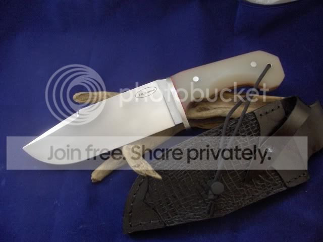

Baton this, I entered this into the Camp Knife Challage and I believe it was the only knife to complete the baton task, with alot of beating. Is this a job for a knife, only if designed for it, that is what I did with this one. The knives I have seen that are broken were designed to be used a normal camp knives and only in very extream situations should the be beaten to death. THis one will take a beating but as the reviewer stated not a good choice to peel potatoes.
