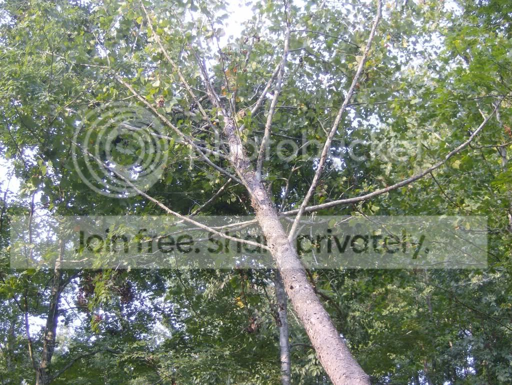

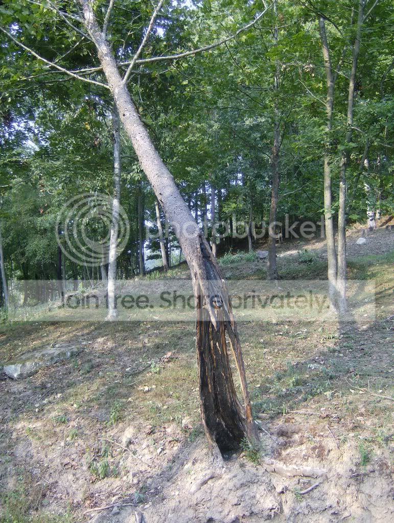

This tree was snapped in two by a severe storm back in june, thought that if I left it alone it would come down in another storm but we really haven't had any more since then to amount to anything. The other day I tried burning it but it is still too green, then I tried pulling it down with a rope and my truck but wasn't able to budge it and didn't want to snap my good rope:grumpy: I REALLY don't want to stand underneath it and finish it off with an axe not really knowing how or which way its gonna fall. Any suggestions?

That sickening snap is what I'm afraid of...it may not look it from the pics but this is a pretty good sized tree. Should I chop at the base as you would with a normal tree or should I chop on the unbroken side of the snapped area?
I don't know, but from the pics, it looks like even if you were to cut the base, you'd still have the same situation, as it is caught up in some other tree(s) at the top. Not too sure cutting it there would make it fall. I actually think you may have to fell the live tree holding it up.
Listen. When a tree has a lean to it there is a buildup of force, just like in a bent bow. Men have died hitting them with axes. Hire someone. That is a loaded gun.
I'm no arborist but I'd suggest a chainsaw instead of an axe. notch the tree on the undamaged side about 1/3 of the way through ( from the side of the tree, not standing under it of course). Then ,from the damaged side, cut down on a 45 degree angle.start 4-6 inches above the notch and cut towards the notch. unless your in a crazy windstorm I think it's pretty safe to assume the tree will fall in the direction it's already leaning towards. of course the safest course of action would be to follow the others' suggestion of hiring someone who knows what they are doing.

The biggest thing you have to worry about is the trunk shearing off where you make your cut and the end coming down at you.
The crown of the tree is being held up by adjacent trees. As Fiddleback said, there is a lot of energy stored up in the trunk, and it should be approached carefully. Lots of people have been hurt or killed taking down trees like that.

What is the diameter of the tree? Is the top of the tree hung up in another tree's canopy? The tree is still alive but will be dead by next Spring. You can wait for the leaves to drop this Fall so you have a better view of the branches in the upper canopy before you cut it. From the looks of it, I would go with Spyderguy's advice.
At its base before it split it a was approximately 2ft in diameter give or take a few inches. Yes it is hung up in the tree behind it:thumbdn: I may try burning it again as well after it dries out some more.

Wow, that is amazing how the perspective of the photos fools you. I thought from the first picture that the tree was abou 6" in diameter, not 2'. I'm not a professional tree man, but I've felled lots of trees, from the days when I worked in natural resources conservation, to most recently clearing out a cabin site. Danger seems to go up exponentially with tree size. So if that thing is 2' in diameter at the base, its a big dangerous boy. Also, and most importantly, its in a screwy position. As others have noted the canopy is hung up in other trees . That gets unpredictable. It is bent and loaded with energy as others have also noted. The last thing and perhaps the most concerning for me is the fact that the lower trunk is damn near gone. When you are making felling cuts on an intact tree you are more in control and have sound wood to work with. There is no way to know how to control the fall with your felling cuts in that mess of a trunk. HIRE AN EXPERT and KEEP WELL AWAY from the darn thing.
