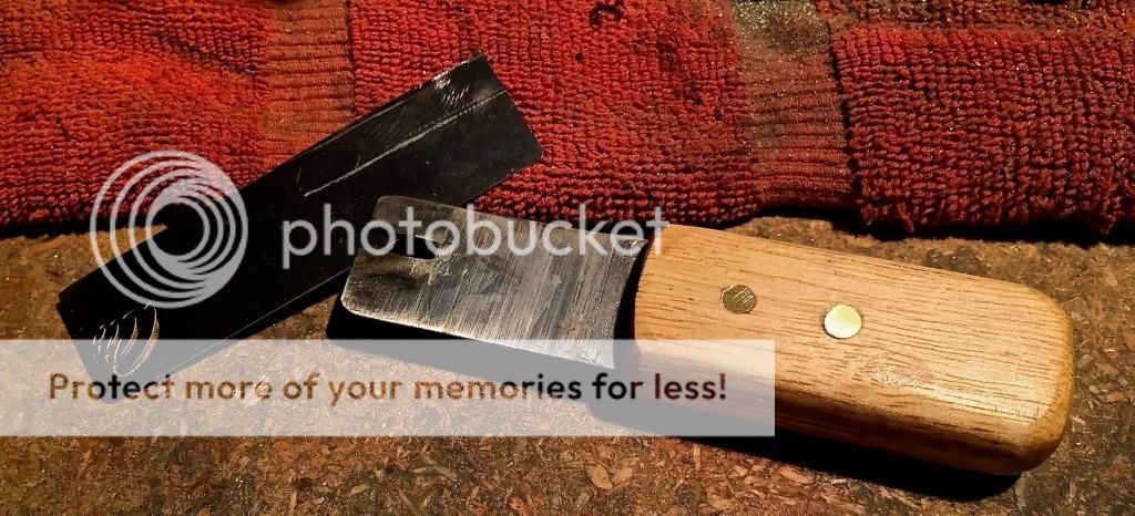

Anyway I needed a Slackener and came up with this idea. I used a dremel and cut a slot thru a razor blade. It's .009 thick and worked like a charm. Not to mention it was cheap.

Very nice work Dean! I also respect the ingenuity in using the razor blade as a slackener. its funny I came to the same solution. Works well.

Lemmy Caution; I also respect the ingenuity in using the razor blade as a slackener. its funny I came to the same solution. Works well.
Some times you work with what you got, I guess great minds think alike. :)

I made one out of a metal business card and my dremel, and added a handle made from a piece of oak salvaged from a trashed piece of patio furniture. The handle makes it much easier to remove from the knife.
How thick is that piece of metal?

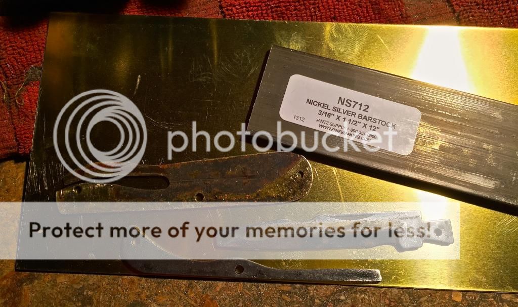

Okay, so I have now made many mods from TL-29s, and quite a few are single blade knives. This has left me with a small collection of leftover parts, namely springs and screwdriver blades, along with a few locks. I have gotten more adventurous over the last few months and decided it was time to build a knife from the parts, which meant I needed to get a hold of some brass sheets to cut out liners, and some nickel silver bar stock to cut out bolsters (which I have been doing for a few weeks now).
Here you see my raw materials, including the spare parts:
I used the scales from another TL-29 to trace my new scales and holes on the brass. I clamped them together to precisely drill the holes (this is very critical). Being off just a hair will mess you up. I then shaped the scales by temporarily pinning them together and grinding them to shape, so they would be identical.
I cut out some bolsters from the bar stock and soldered them on, and then ground them down to shape. Again, once I got close to finished I pinned the scales together again, along with the spring and liner, and ground everything to make it all identical.

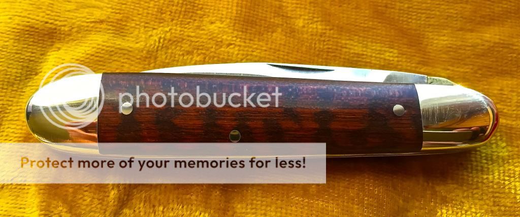

I decided to use some snakewood (which, by the way, is super expensive) for the scales, and I also did some file work on the spring to make it look like a snake.
It took me several days, but I ended up with a very nice finished product. The cool thing is that I can get two knives out of one using this long and arduous method.
It is not perfect, but I ended up with what is likely my best work yet. The rest is going to take practice. I am building up my confidence to get to the point where I start cutting my own blades and springs.
Here are some pictures of my finished product:
Notice the subtle snakehead and body theme on the spring:
I filed the end of the spring to look like a rattlesnake rattle:
I really love this knife. It is a perfect size and locks up like a vault. It works great as both a whittler and a general purpose knife.
