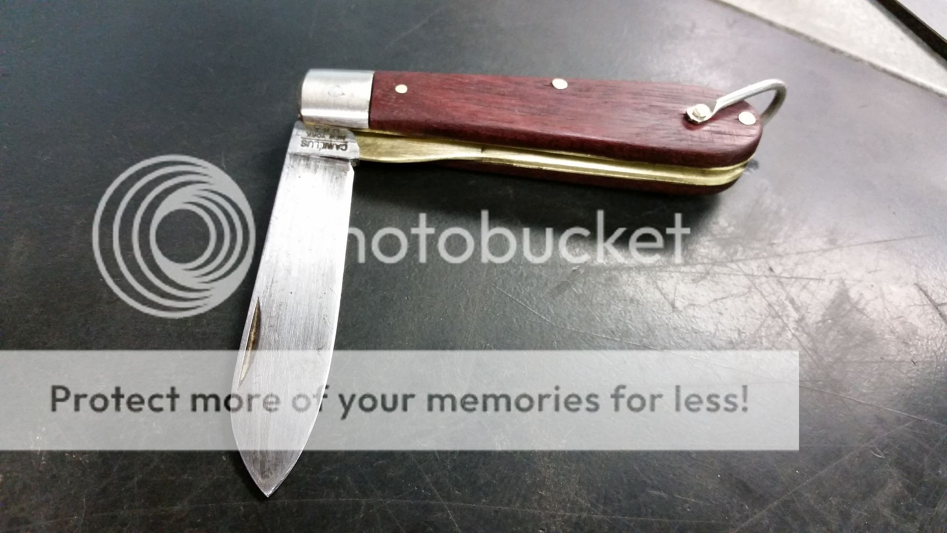

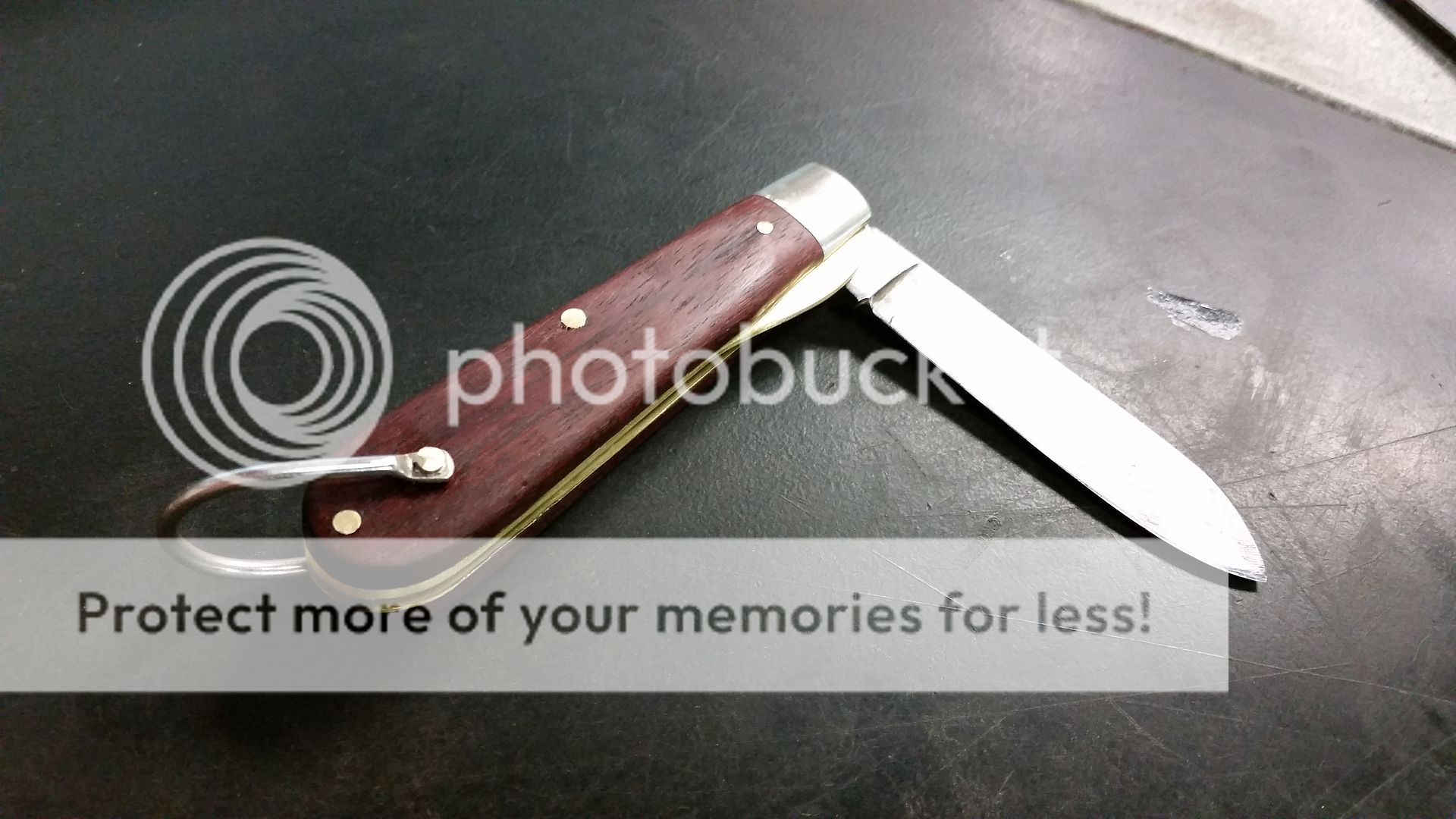

A monster, indeed. After a hurried trip to Harbor Freight yesterday to pick up a 1x30 belt grinder, I came up with this:
I removed the screwdriver blade and center liner, modified the spear blade's tang to function with the liner lock, and recovered in purpleheart. This will be a gift for my wife, who loves pretty much anything purple. I still have a lot to learn, but man, this is fun. I flubbed the mark-side cover-to-bolster gap, but the pile side came out well. Unfortunately, due to my arthritis, I can't work for too long at once before having to ice down my hands, but I suppose that's best so I don't rush anything!
Very nice looking knife Parke1. The Purple Heart will age to a very pretty "purplish brown" with time. I have the same sander and it is a great tool for a great price. Mine is a little loud but it works well.

Thanks for the compliments! GT, my slightly poor photography skills help the knife look better... ;)
Really nice! Keep at it and you will quickly improve. I too have issues with hand pain, which makes me slow down as well.
I cannot notice a gap in the picture, but have flubbed this as well before. I found that squeezing a little super glue in a gap and quickly sanding with fine sandpaper before it sets causes the sanding dust to fill the gap nicely.
