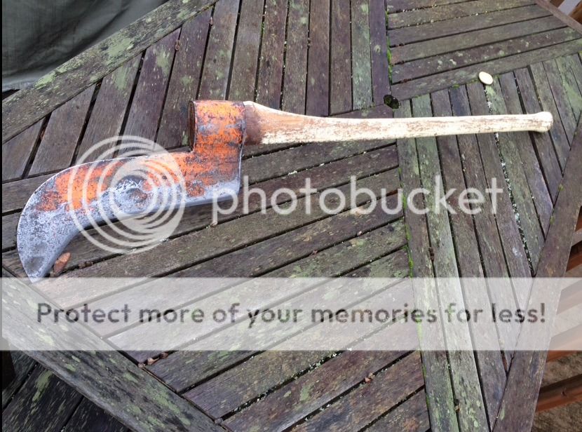

Just for fun I dismantled this Council 12. Hand run wire brush on the blade to get loose paint/corrosion of it. Spent 2 days in vinegar then again with the hand brush. I kind of like the look with some of the original paint intact on the head.
Took it out back and tried it on the Himalayan blackberry- took a few swings to get the hang of it. This thing powered through them easily. I rehung it a degree or two closed- preference for more "draw" control with my monkey arms...
It came to me with two wedges installed - Red Devil steel wedges with the full logo on them- I've only seen them in bulk or marked "R D". They were a bear to remove, trying not further any stress cracks. Dropped the head about .25" at the same time.
I stood the handle for 24hrs on both ends in boiled linseed oil before rehanging. I lightly sanded the handle just to clean off some junk before BLO. The painted handle kind of fit with the head.

It's a good look.
I've always had concerns about kerf and wedge hung brush axes versus strapped brush axes. But maybe I've worried needlessly. Your hang certainly looks secure.
Halfaxe- cool billhook. Wish I had welding skills to fix my own stuff. My friends/coworkers do too.
Square_peg- I understand your concern. My experience with that style of brush axe is limited. It certainly seems as solid as when I got it and used it out back. Thinking it will show some wiggle before it comes off. Without a kerf cut, those wedges displace a lot of wood.
