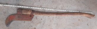

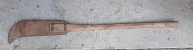

Ditch bank blades are a different tool with a lighter weight blade more akin to a short double-edged machete blade bolted to a double bit axe handle
So, while I thought this was a variation of a brush axe, I now know better; a ditch bank blade:
I haven't found any marks, but there might be some hiding under the rust. I also have two brush axes to post once I get the photos done.
Bingo. That there's a ditch bank blade. :thumbsup:
