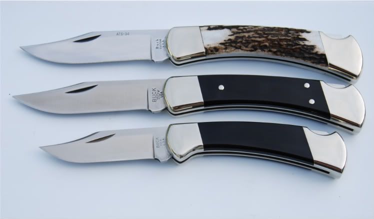

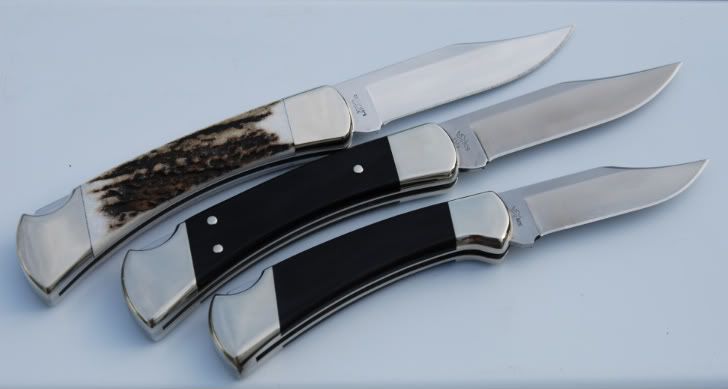

If its a premium steel it will be stamped in the blade. BG-42 and ATS-34 are stamped on the left side along the upper side. S30V and CPM-154 seem to be stamped on the right side tang. I'm not aware of any other premium steels being used other than damascus and you don't need a stamp for that one.
You can see the stamps on these knives of mine.
Notice the Paul Bos S30V stamp on the two Buffalo knives.
If you don't have a stamp its going to be the house steel for what ever period the knife was made. So Start of Production to 1980 is 440C, 1981 till 1992 it was 425M, and after 1992 it has been 420HC.
