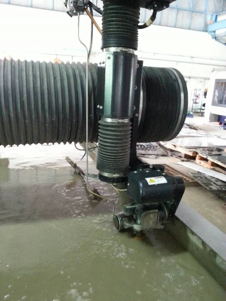

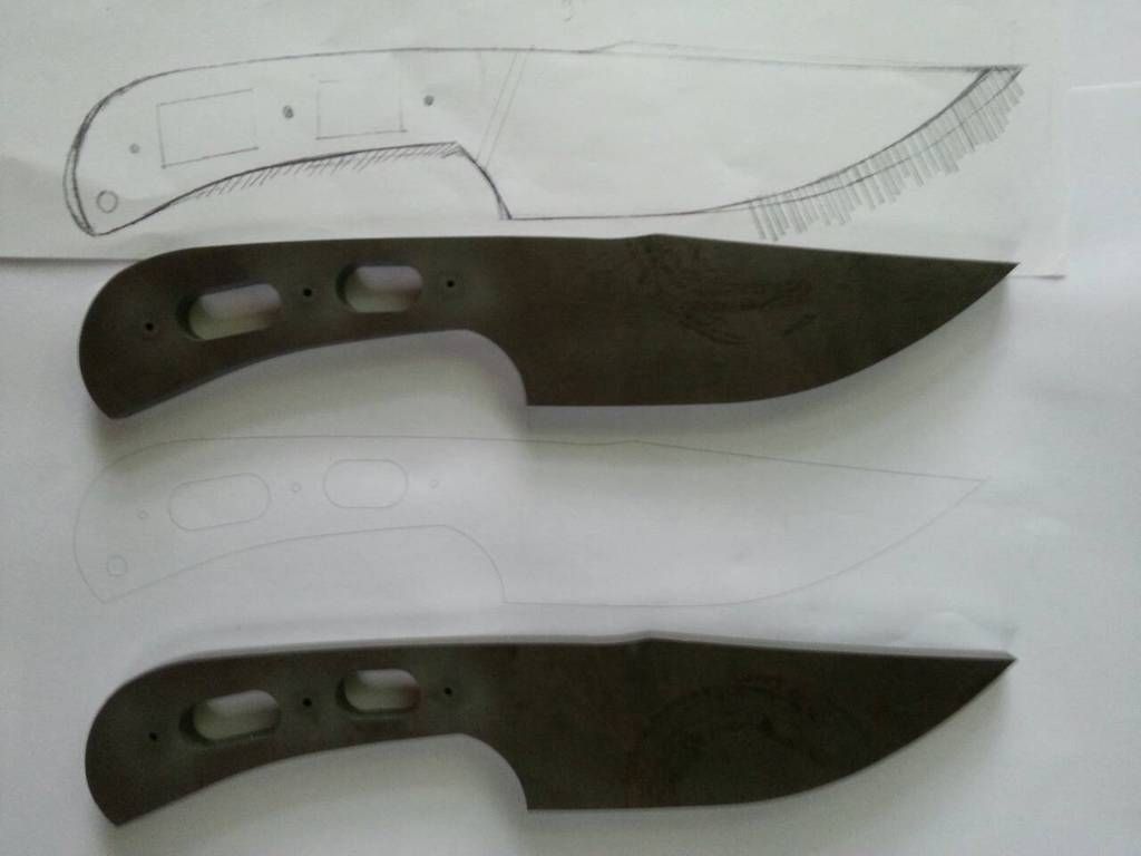

I have the 7 piece of CPM-3V blade going to be finished soon. This will be heat treat by one of the best HT equipment for knife blade in my country, very precise electric kiln with molten salt quench and double cryo. Molten salt temper too.
Actually I have one finished blade made from the leftover piece but it was HT by my friend with only plate quench and sub-zero. I have done some robe cut test and edge flex test with it but need to be pause becuz it still don't have handle installed and pain to use.
This is the pic of pic right of the water jet cut.

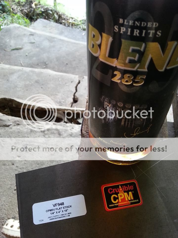

The raw piece of steel plus shipping and tax cost me $250 :eek:

And DAMN what size is the sheet that costs 250?
There are only one type of powdered steel sold here, TSP4 which are equivalence to CPM-M4 and it come only in round stock so can't make use of it.
That blade shape is very similar to my favorite knife, the winkler belt knife TAD edition in cpm 3v steel, comes with tapered tang and is EXTREMELY well balanced and ultra comfortable in hand.
4" x 18" x 0.290"
In fact I ordered 0.25" thickness but it fortunately came oversized :D
My friend said its look quite similar to Winkler's Belt knife too, unless it will be sabre grind and has fuller :D This is wood model.
very nice, the high saber with fuller makes it look mean. What ever you do it will be tough as hell at .29 thick 3v.. when it gets done post it up for us 2 see, what handle material are going to use?
Thank for the compliment!
I'm lucky that the maker who going to grind this is very specialize on cutting competition type of blade which has thick spine but very thin edge. I'm not a knife maker my self but I love to work some fun project with them.
The handle going to be green micarta with carbon fiber liner, 6AL4V pin and G-Flex epoxy from USAKNIFEMAKER site.
Excellent choice in handle material as well.. should be quite handsome with the carbon fiber liner, and Micarta always feels good in hand. I'm a little jealous haha
