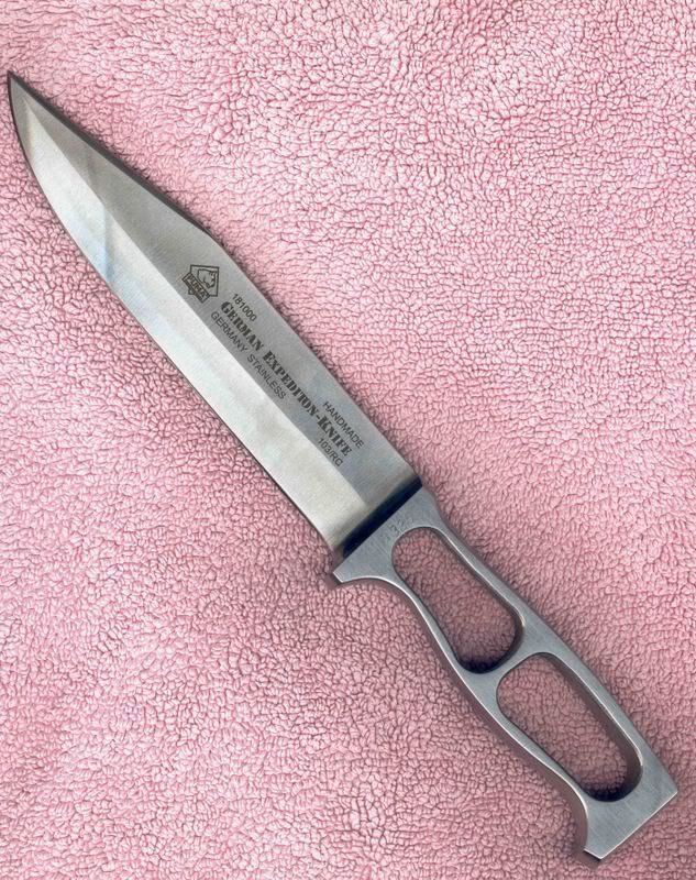

The only knife I know that is made for batoning allowed by the manufacturer is the Puma German Expedition Knife.

Would a Scandi or convex grind knife be better suited to batoning? I would think that a hollow ground knife would bind in the wood, and would require some lateral wiggling of the knife to get it loose. I would worry that the lateral wiggling trying to free the knife would stress it a bit too much?

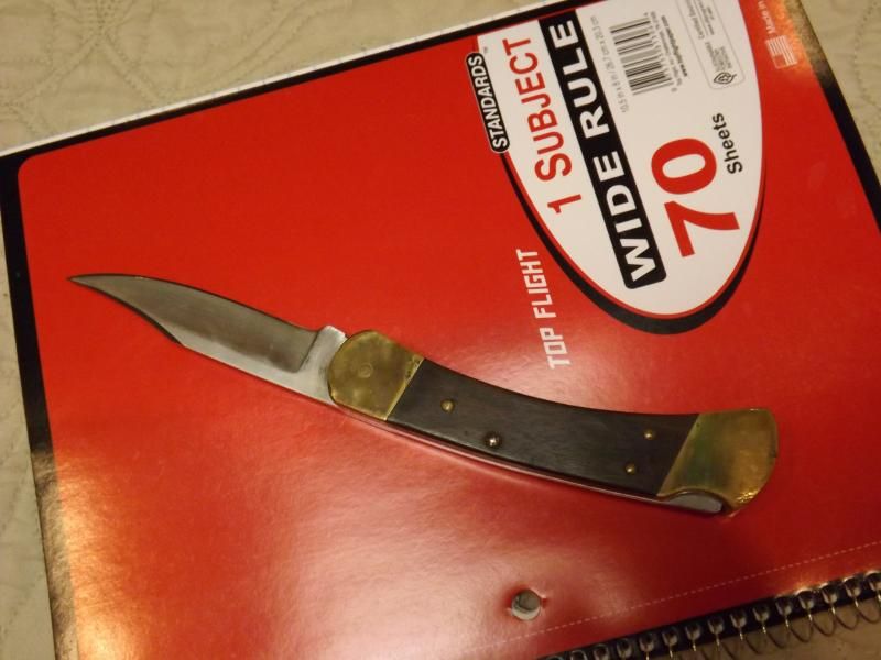

When I was in the Navy in 1988, we were returning from deployment, and one of the guys in my division asked to borrow my Buck 110 for some work he was doing....turned out e was removing fancy-work from a railing and had broken the tip of the blade wile prying the stuff off. another guy took it to the machine shop and basically filed it back to a point. I still have the knife and on one hand want to send it to Buck for either repair or replacement, I may have to pay a fee as it was done by misuse, although the misuse was done by someone else.

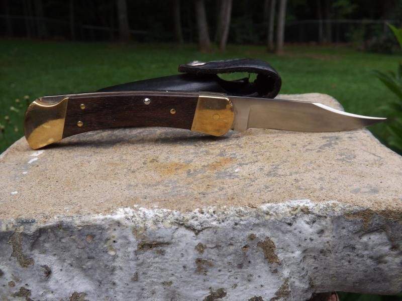

Hey there shipmate. This post reminded me of this 110 I carried for quite a bit of my time in Uncle Sam's Canoe Club. Though mine hasn't been abused other than frequent sharpening with perhaps poor and aggressive technique I've thought about sending it back to Buck for a reblade. I only recently found her after I guess 10+ years as I had stashed it in an old toolbox I hadn't opened in years. Having her back after such a hiatus I decided that a new blade would forever remove the history that she and I share so I think she'll stay as she is. Might use her some more and even touch up that edge now and then when needed though much more gently than before. Something to consider anyway. Thank you for your service.
Before photos after finding her.
After some "at home" TLC. The sheath turned out lots better than I expected it to. Glad I didn't get her rebladed.
