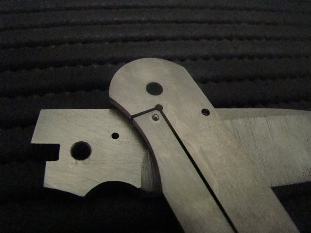

To resurrect an ancient thread, (because it's an extremely high value thread) the ball. I heard the ball discussed, but I never saw where it is installed, and so don't understand what it does.
I also don't understand what makes the lock want to bend inward and do it's job.
Thanks!
The ball in a liner lock is the detent for the blade. It's a tiny ball bearing that fits into a small hole in the lock, and when the blade is closed it snaps into a little divot or hole in the tang of the blade and holds the blade in the closed position, using the springiness of the lock to hold it in place. As far as the lock bending inward, when you bend a piece of metal beyond a certain point, it takes a "set" and wants to stay in that position and will continue to spring back to this position when flexed unless it is bent back the other way far enough to straighten it back out. With a liner lock the lock bar is bent inward and the handle scale on the lock side prevents it from being overextended in the other direction, so the lock bar will continue to favor an inward movement, thus snapping into place behind the blade tang whenever the blade is open.
Thanks, Scott, reading back over the thread, I realized that my chances of getting an answer from a banned author are low.
Have you got a picture of where the ball goes in the lock?
I think I see, now. I was hoping for a shot of the installed ball.
The ball is pressed into the hole being drilled in the last picture of post #28? What keeps it there?
Here's a pic of a detent ball in place. You can also see the corresponding hole in the blade to the left. I think the ball is kept in place by drilling a hole that's just a half a hair smaller and then forcing the ball in to the depth you want it, so it's held by friction. I'm not 100% certain, but I think that's how it's generally done.
Thanks! It makes perfect sense, now!
When you disassemble a finished knife, can you get the ball out, or is it being held in place?
