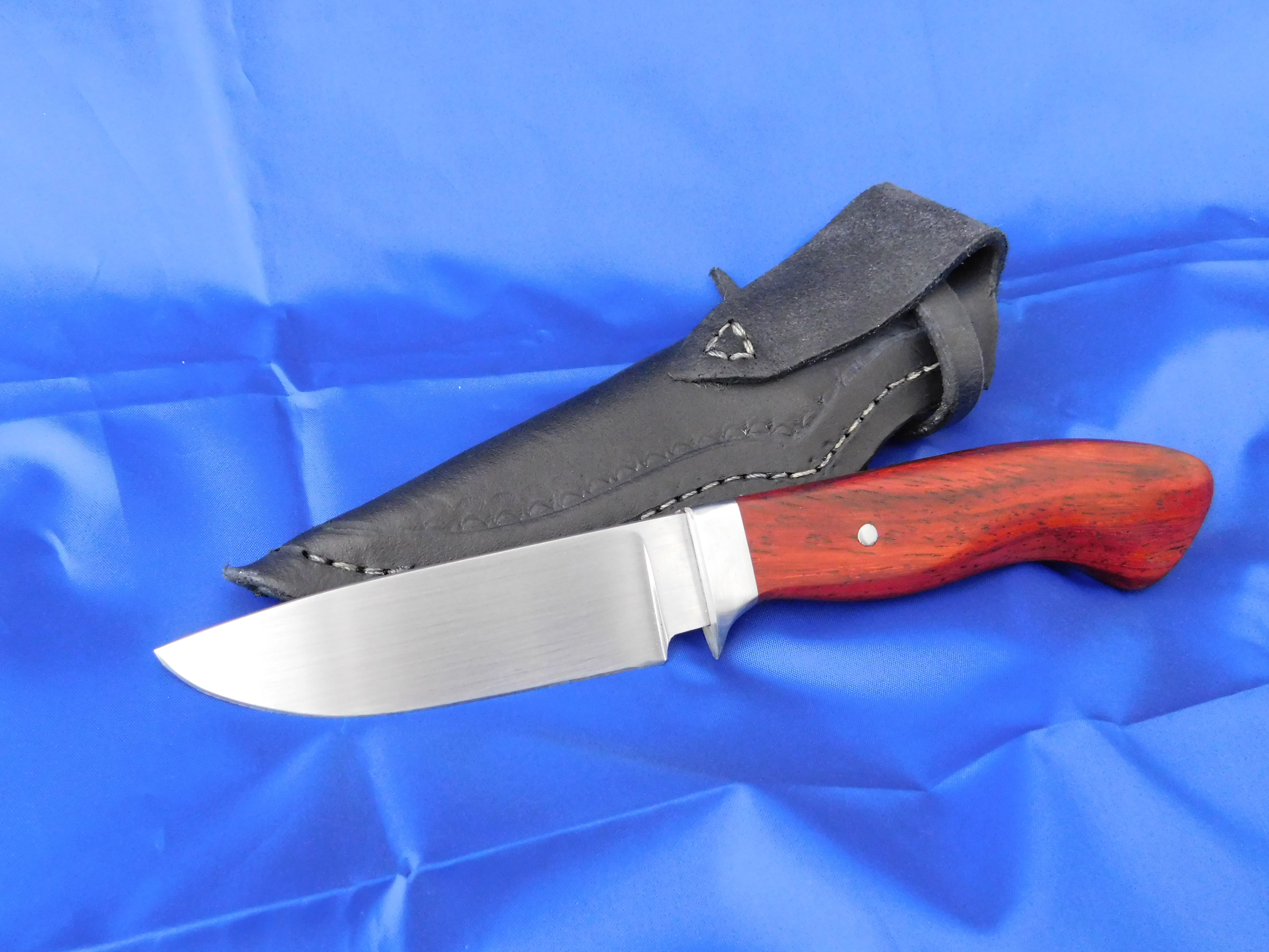

And arcing handle like this?

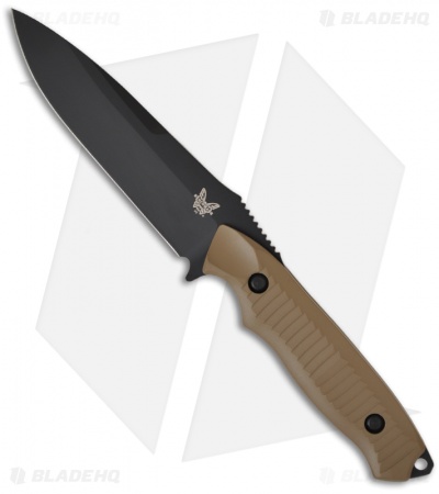

Or a more contoured handle like this?
Or maybe a more bulbus handle like the murray carter neck knife
This is what im thinking
With g10 scales, corby bolts, and either m390,s35vn, or my personal favorite cruwear.

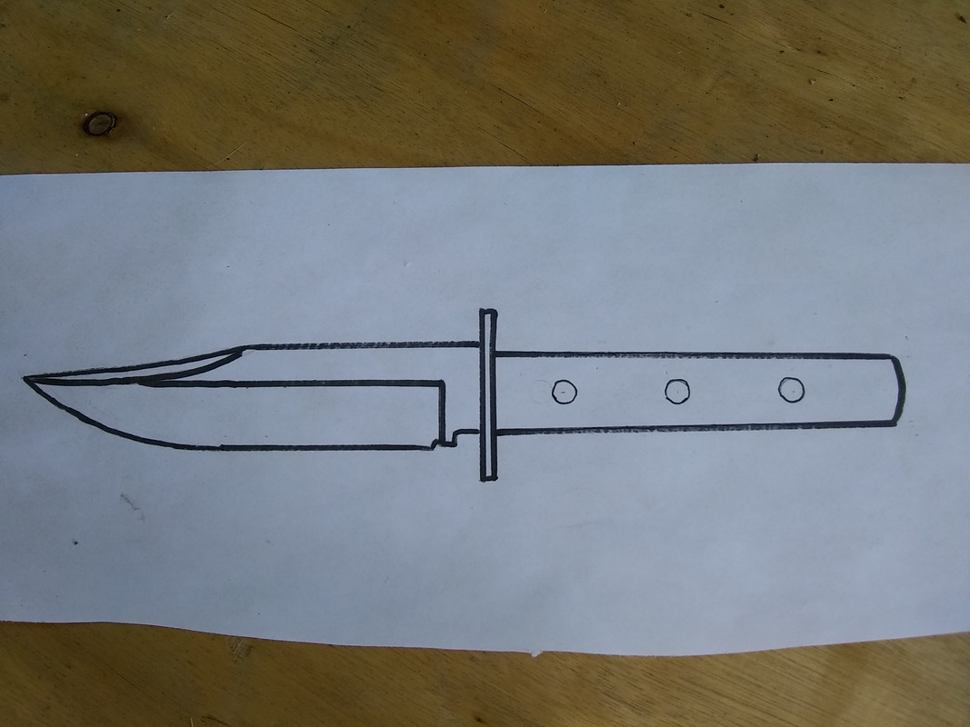

Thats basically what i came up with in my drawing.
Except instead of the 3.8in handle im going with 4ish

It's a small turn of the century style Bowie hunter
8¾ oal
4¼ handle
With stag or jigged bone scales
4-3/8 long, 1"wide, 1/8" thick , 2/3 sabre ground 1095 blade.
1/16 thick brass guard, 3 brass rivets.
