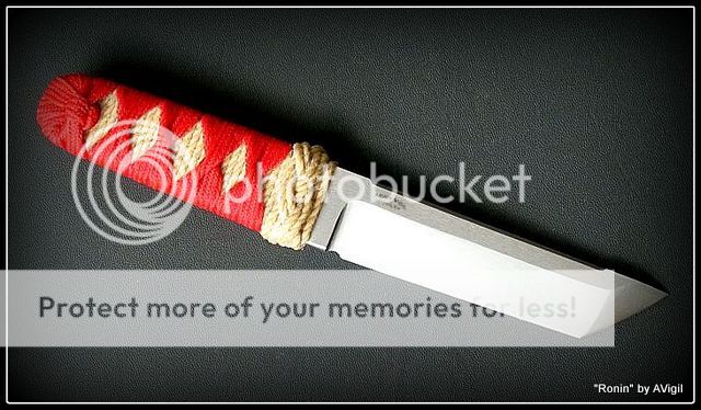

I really admired Phill Hartsfield and his cord wraps haunted my knife dreams for years to the point I love making them and happy I met him. Here is one of mine with much respect to the Hartsfield tradtion
