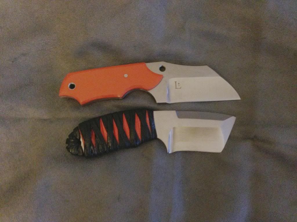

The bottom is a modern Japanese-styled two-toned paracord wrap on a snody compensator shank. I couldn't get the folds right on the black paracord so it just crosses over flat, but it gives phenomenal grip.
My first attempt.:
I need to get better epoxy for easier application, and do a thicker wrap.
