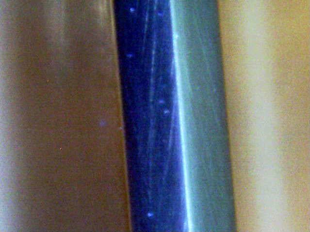

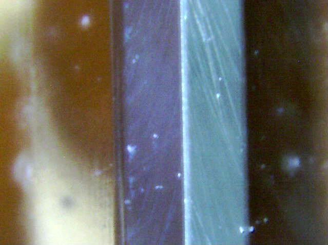

VG-10 delica sharpened using DMT aligner and benchstones. VG-10 seems to be one of those problem steels with burr's but for whatever reason it seems to do better when perfect angles are applied.
JYD II CB sharpened by hand (micro convex). CPM-D2 is the complete oposite, it is one of the few that sharpen with almost no burr. CPM-D2 also can reach a extreme level of sharpness but like D2 is seems to perform better with a little lesser of a edge.
Sorry about the glare I am using flashlights on either side of the blade to provide enough light.
