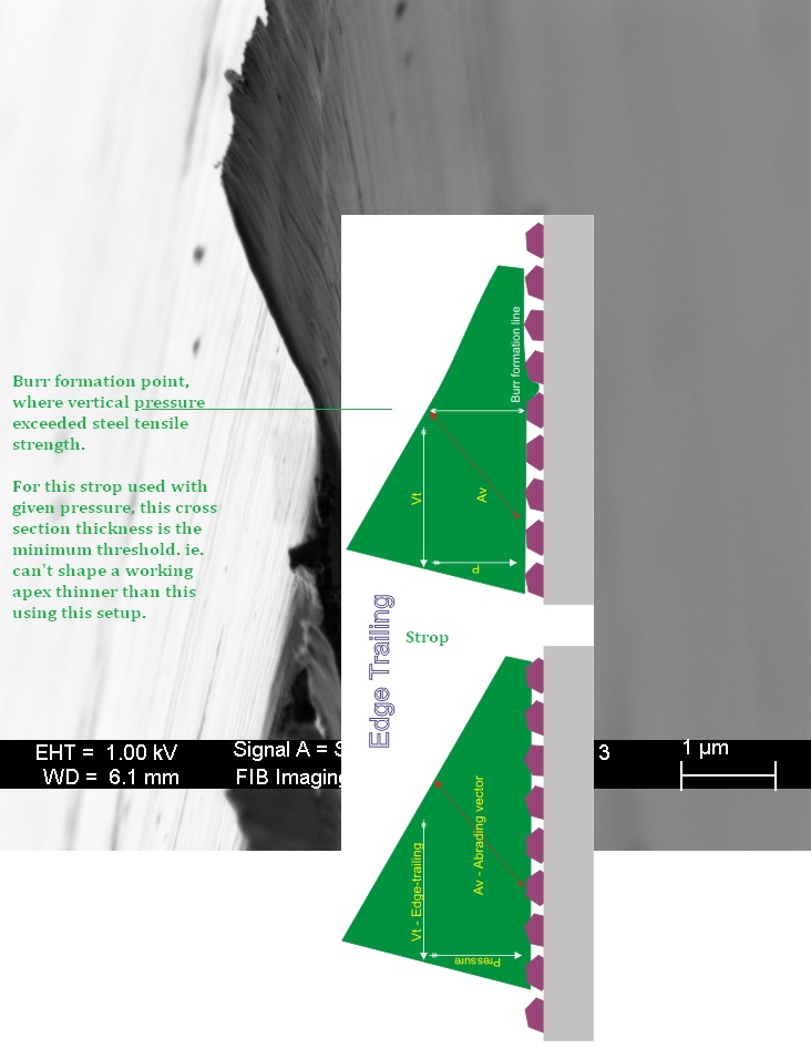

I am following Todd's blog here and figured I would post it up for others information... the SEM images are some of the best I have seen. In this article he is looking at multiple aspects and questions to both raising a burr and minimizing/eliminating it.
One of the interesting things that I found was that the edge does indeed become thinner at the very apex the further up in grit you go. This has been theorized but I had not seen it proven until now.

There are two major types of burr as I see it. One is the bits of steel that form at the apex because the abrasive cannot cleanly remove every last bit of steel as it trails off into space (trailing), or as the abrasive enters into the steel (leading). A percentage is shoved out of position, either because the angle of the cutting mineral wasn't optimum or the steel deformed out of the way ahead of the mineral's passage (per the second type of burr below but on a much smaller scale). This is left behind per pass and over the course of a few passes it builds up to an appreciable level - heavily dependent on the manner in which the abrasive is presented etc.
The second type of burr is the curling that is formed when the amount of force applied is greater than the steel's ability to resist. There will be tailings at the edge per the first type of burr, and along the curving surface as it veers away from the abrasive surface. The curvature issue is mostly a product of force and what the steel can support - this can be eliminated by using an abrasive that cuts the steel more efficiently at lower force, using a steel that has more lateral strength, or increasing the edge angle.
The burring by abrasive contact has more components to it and has been covered to some extent in earlier posts. Factors that reduce this tendency - less applied force, greater friability of the abrasive, looser attachment of the abrasive to the underlying surface (mobility), conformability of the underlying surface, higher contact speed, with some steels a higher Rockwell value.
The mineral is basically a shaped ploughshare driving through the steel. The steel builds up and is cut free, builds up and cut free - abrasives work with a scratching mechanism for the most part (though CBN can actually shave curls off if the abrasive orientation is just right). Continuing with the analogy, the ploghshares to either side and behind all grind off the wake-like buildup of the abrasives to either side and any left in its path. You generally won't see burrs on a flat surface but will see grind troughs that terminate in mid stride if using a scrubbing pass or stopping cold in the middle of the stone - occasionally there will be a bit of debris still attached but not often.
If the ploughshare has mobility, can fold back on itself, sacrifice part of its physical structure (friability) or otherwise deflect when it encounters too much resistance etc, burring will be reduced. This is why lapping operations produce the frosted surface, and also reduced burring - likewise slurries, softer waterstones etc all tend to produce less burring - all other factors being equal. Speed reduces the burr formation because the ability of the steel to hang on as the minerals scratch away at it is partially a form of tensile strength per an elongation test - higher speeds result in less elongation before failure. At hand sharpening speeds I do not believe this is a factor.
I still have reservations about the conclusion reached in the earlier blog regarding coarser edges and inability to create high points that are as thin across as with finer abrasives (albeit over a smaller total percentage of the edge). The absence of burrs or burr precursors on the sample edges leave me curious about how they were prepared specifically. I have some optical images taken at 400 and 1000x of edges finished at medium grit value (800) and the high points appear to be quite acute - low sub-micron. Granted they are not with the clarity of a SEM at the same magnification, but even accounting for some lack of focal clarity they edges look mighty thin.

By ploughshare I mean the head of plow, like one being pulled by an ox. We don't normally think of it like that, but the abrasive is really a primitive plowhead. Picture if you lashed a sharp rock to a beam and added handles, and used it to plough furrows for planting. Only in this case it is a very sharp, tough rock, and you're driving it across steel with immense (for the scale) pressure being applied. Is not much different than dragging a nail across aluminum. It only gets difficult to imagine when you have to account for the entire field of abrasives moving in a unit - how does the cause and effect, easily seen when there is a single abrasive point dragging across a metal surface, change as you switch to a whole field of abrasives.
Next is what happens as you change the exit/entrance angle and vary not only the amount of support the dud metal has when the abrasive passes by, but the angle of the intersecting planes - in effect limiting the depth the abrasive is allowed to engage at the intersection as it cuts free. For example what happens to burr formation at the exit/entrance corner if you grind one plane of a 120* angle as opposed to the corner of a 30* angle? What happens to burr formation at the exit/entrance as you grind a 1/32" diameter rod opposed to a 3" diameter rod? Now imagine what happens as your furrow ends on an overhang and your plow passes off that point in space and/or catches it head on the return.
As long as the steel hasn't deflected into a curved burr (#2) it is just some tailings, they can be removed pretty easy. The attachment point is small and weak though. If the attachment point also encorporates some curl, removing the burr gets progressively difficult. The burr itself can readily flip if the applied force is greater that its ability to resist - that abrasive will remove some of it, but it will deflect out of the way and do so with increasing ease per number of flips and the abrasive will have less and less effect - so very important to use enough force that the abrasive can remove the burr but not enough to flip it, or at least that it can shrink its length/size before it flips each time, reducing the amount of leverage it has.
The burr is also a monent in time. On a clean edge with light pressure etc, one can make several passes on the same side before any appreciable amount of dud steel will form on the edge. If the burr is being ground down, you can get to a clean apex and have a bit of grace period before another will form - just have to increase the number of observation stops to catch it at the right moment during that bit of grace period.

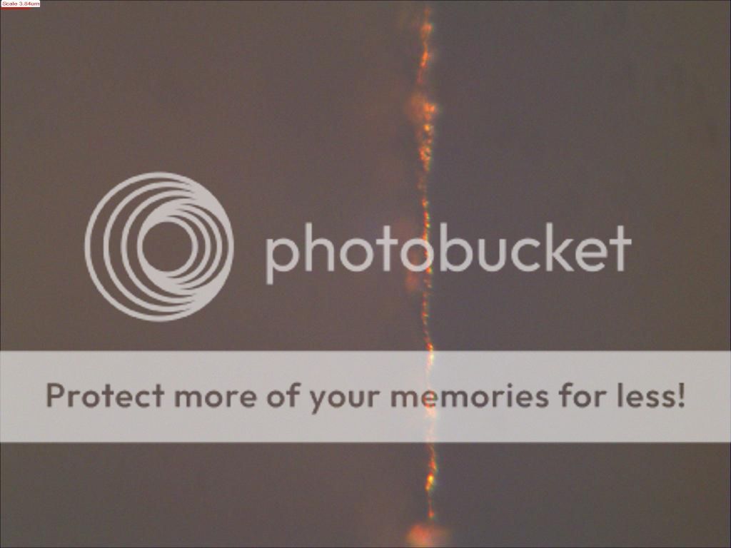

Here's an edge on - the scale upper left is under 3.8u, so the edge at its thinnest spots is might narrow. Tough to say exactly as the light scatters some, but well under a micron anyway. We're starting to get away from the burr discussion...

I'm not taking issue with the average overall width, but rather the notion that the coarse abrasive is inherently incapable of creating edge widths at the narrow end of the spectrum (submicron) at all. Keep in mind, for draw cutting those points provide a lot of efficiency. Also, the region just behind them at the low points have sharp edges dropping down into the low spots and still quite narrow. This lends credence to the rougher edge (within limits) having greater longevity across a wide range of chores compared to a super uniform edge that is mostly reduced to pressure cutting (as a generalization).
For additional reference, that is 420HC done to 800 grit and stropped on paper. Part of an edge wear series I did -
