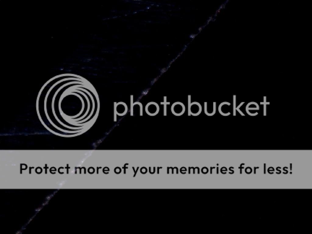

Unfortunately, the result may not be repeatable. After the SEM of the test razor, I honed another razor for shaving and it performed spectacularly. But when I tried re-honing the same razor on the same DMT 325 I had difficult time getting any keenness at all.
Perhaps that had to do with the fatigued steel near the edge. Maybe that's something people who use diamond plates should be watching out for? Not to use too badly worn ones if they want the strongest possible edge.
Maybe this image gives some idea of what can happen with the coarse diamond plates. There are really two grits at work; that of the individual diamonds and that of the surface of those diamonds. The surface of the diamonds refines the edge to shaving-keen; however, the individual diamonds lead to coarse chips. In the image below, two such chips are shown with a 25 micron circle (expected size for this DMT 600 plate). Again, this is just for illustrative purposes. I am not drawing any general conclusions from these few images.

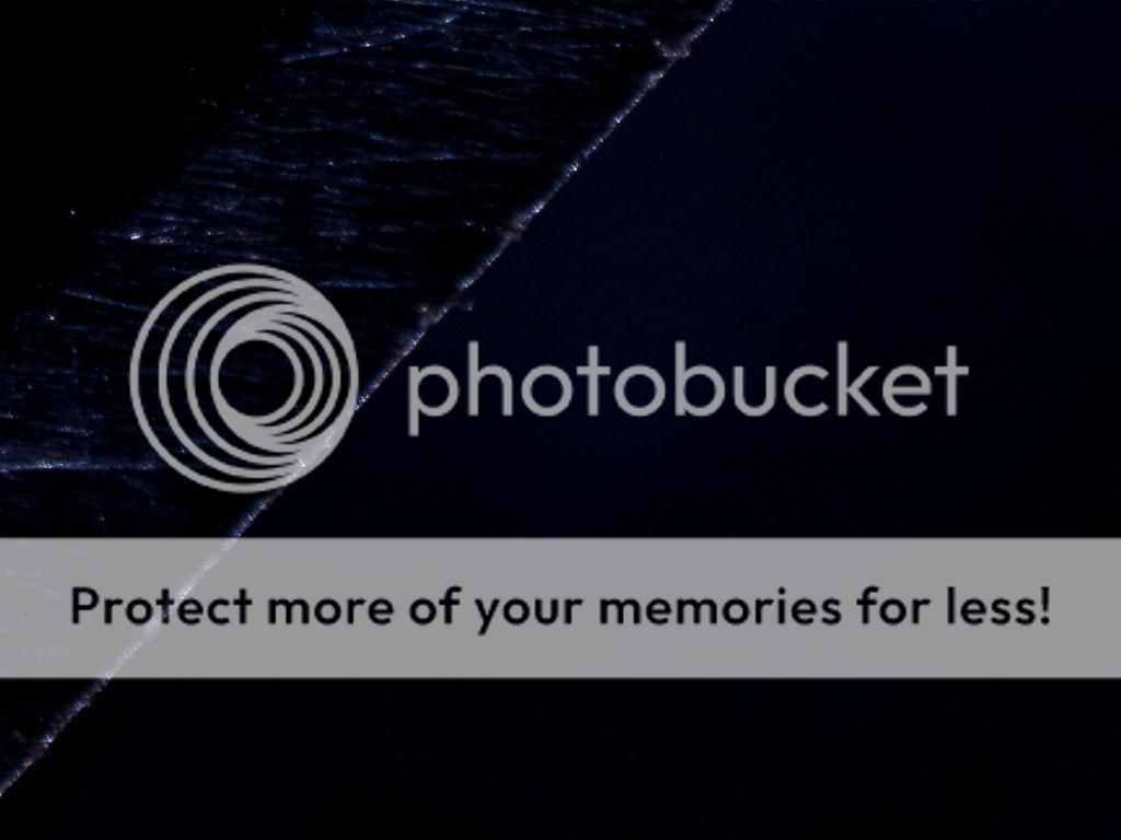

Todd, here are a couple edge shots from my DMT 325 edge I honed up tonight. On the first attempt I got a similar failure to the one you described - only capable of HHT1. On my second, after 100 more very light laps, voila - HHT3/HHT4.
Attempt 1:

Attempt 2:

You can see that the scratches do not reach the edge - the usual indication of a micro-convex apex.
