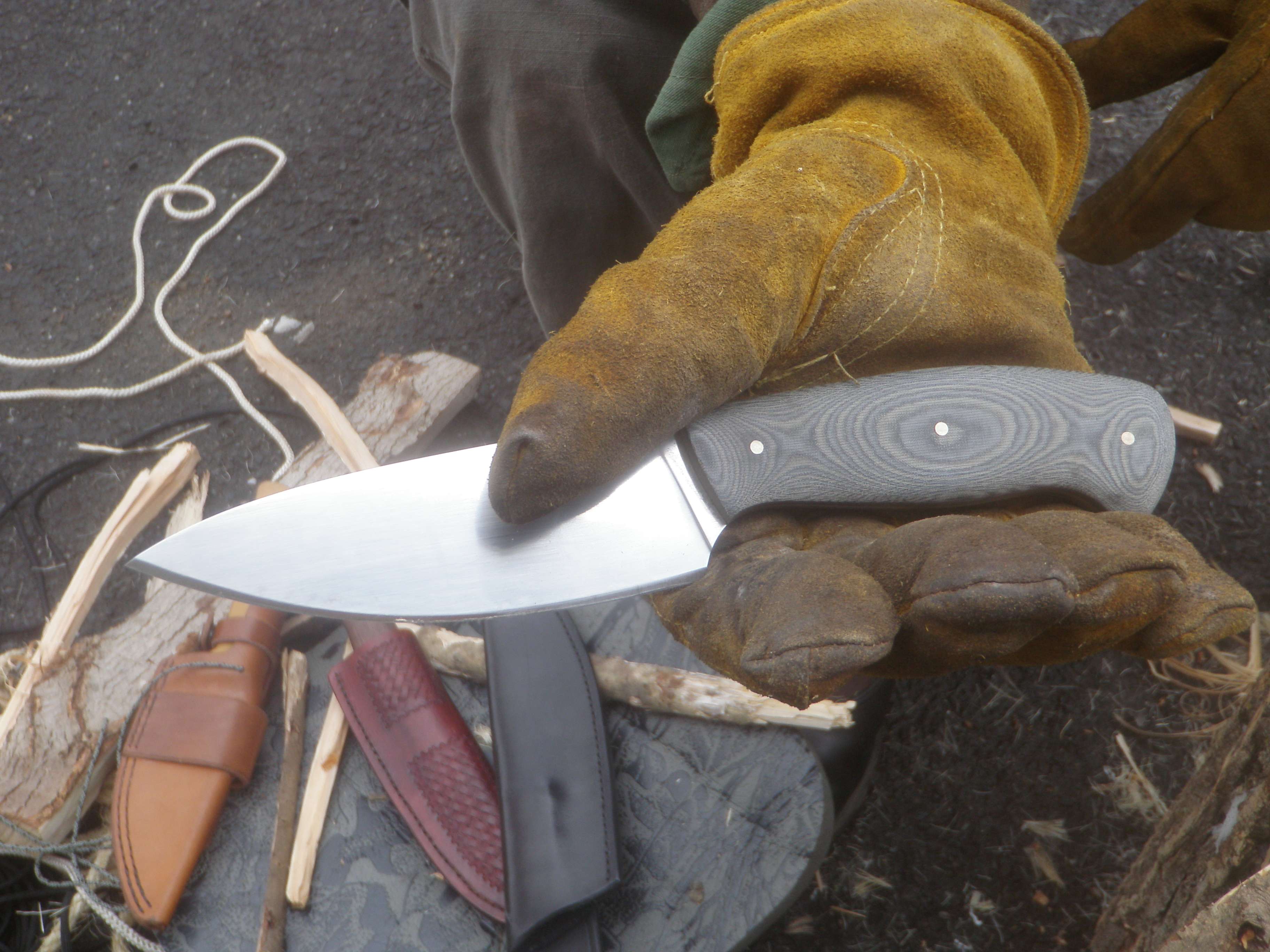

G. W. Schmidt.
Overall I like this knife; I like the blade shape, and found it offered great edge retention, tough the secondary bevel seemed too obtuse to cut deeply in wood; the handle, though tall from top to bottom, is a bit thin from side to side, I found it a bit uncomfortable in my large hand when using it hard; the sheaths worked alright, but the oversize belt loop made for too much movement when trying to remove the knife.
G. W. Schmidt.
This knife appealed to me when I saw it. It had plenty of belly and great pointy tip.
Fit and finish was very good. A nice full flat ground with a high secondary bevel. The secondary bevel wasn’t perfectly even, but it did not hurt the knife’s cutting ability. It had a great finish on the blade and the handle. No gaps, or unsightly glue marks.
The sheath was okay. It held the knife good. The leather was on the thin side and the belt loop was a bit loose. Other than that it was fine.
The blade shape proved handy in all tasks I through at. A little wide for my taste but it cut through would just fine. The tip made for a very good driller.
The maker had good edge on it with high shoulders which didn’t get in the way of it slicing through wood. It did every task very well. The knife is well above par in cutting ability.
The handle was interesting and sexy to look at, but not so sexy after using it for a long time. The top of the handle was left square which was a bit uncomfortable. The birds beak butt dug into my hand in the chest leaver grip. I understand the birds beak on large knives to utilize a three finger grip for chopping, however I am not chopping with a knife this size. The Birds beak butt also made my gloved hand feel a bit cramped, however the handle was thin and wide which lends itself to a secure feel. I did develop some fatigue after extensive use .
Looking at this pic, I can't help but think that if you take the birds beak off the end, the handle would have been much more comfortable for me.
All in all a very well designed knife. I only really took issue with the handle, not that it was bad, just not all that comfortable for me compared to some of the other knives.
The full length made a good splitter and the tip was thin but strong
No problems with whittling wood
Very good work by G.W. Schmidt
