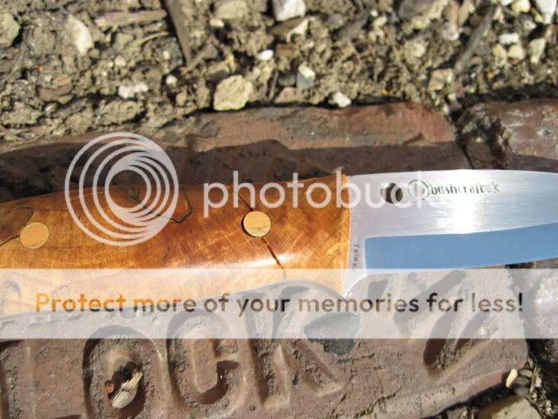

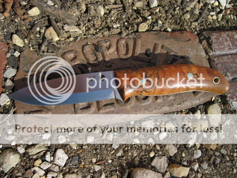

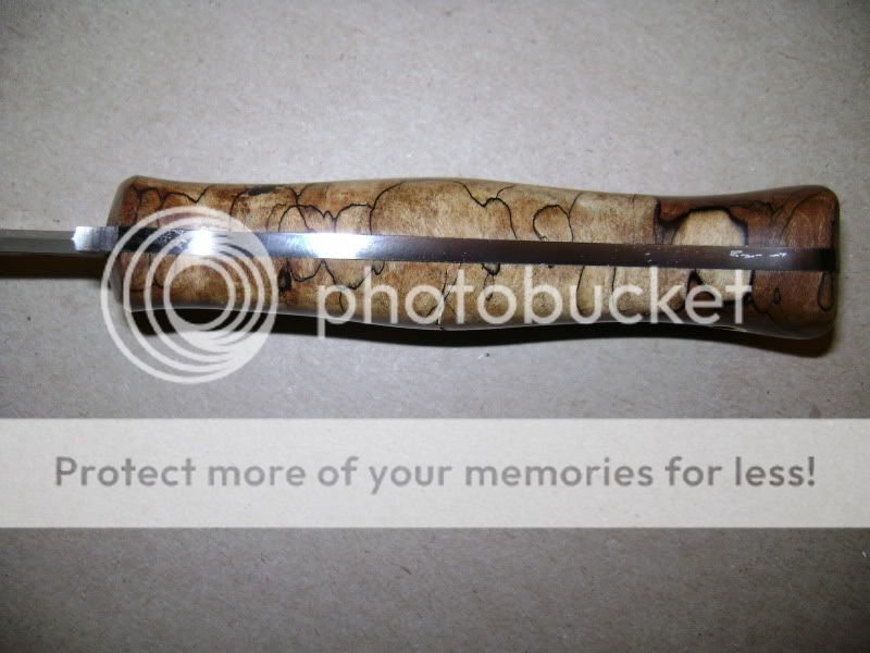

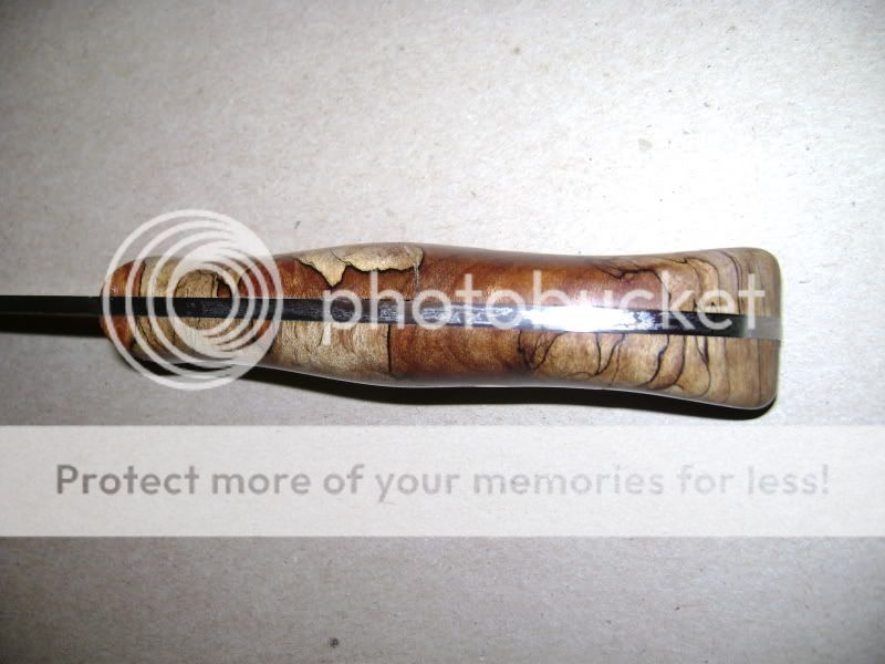

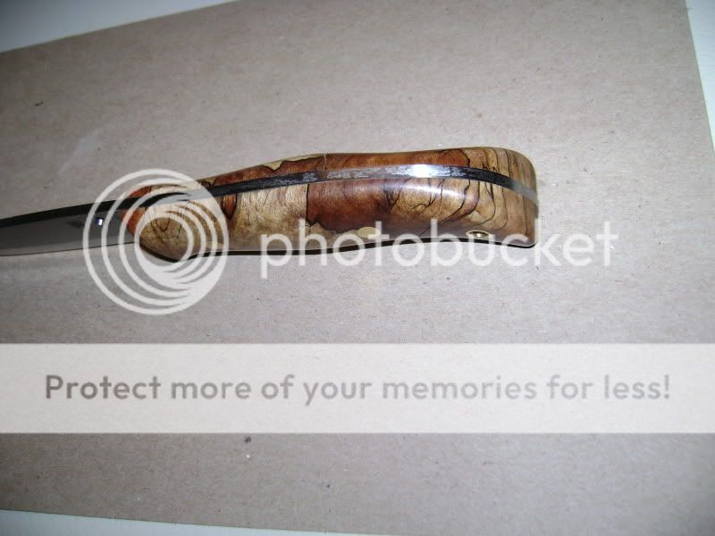

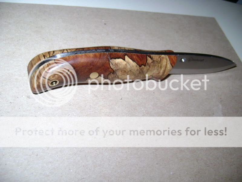

Over the weekend, I was able to patch up my cracked wood scales nicely. I've also carefully ground the metal flush with the handle. Apart from the one spot where I went a tiny bit deeper than I intended, everything is flush and smooth. I sanded all the rough spots down with oiled 800 grit wet and dry sandpaper and refinished the entire handle with 2000 grit. Hopefully the oil kept any mold spores from getting into the air.
There are a few tiny cracks on the surface of the wood and I'm going to leave them alone for now. These appear to be a natural part of the wood and it adds a lot of character. In the mean time, I'm refinishing the handle by rubbing boiled linseed oil into the wood. I'm hoping that the oil will seal these cracks and the rest of the handle so they don't spread. I read somewhere that, "once a day for a week, once a week for a month, and once a month for a year" is the formula to follow. I'll post a follow up photo when it's done.

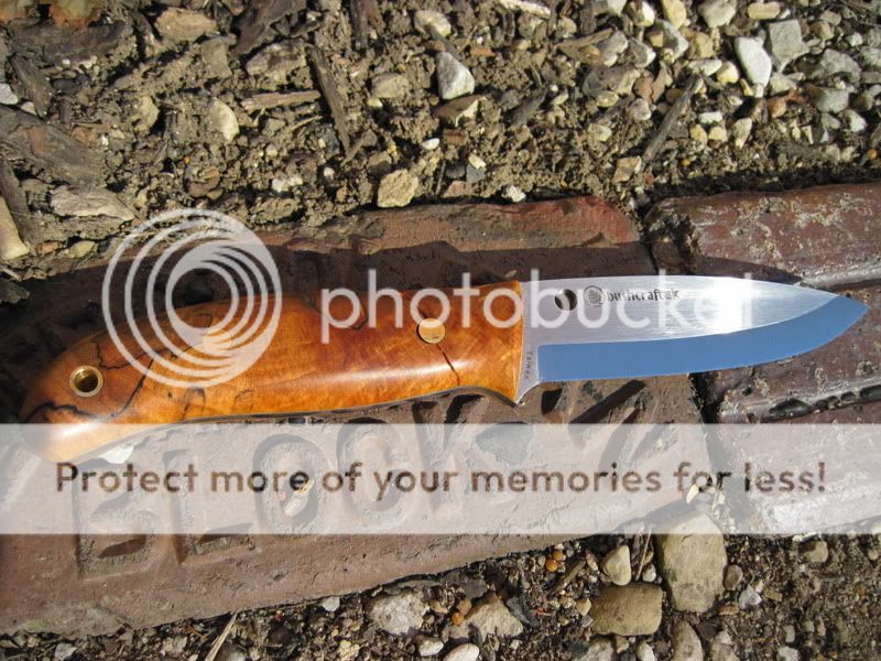

Bushie just came in the mail today! Happy to see that only one side of the handle has cracked near the front brass. Going to let it acclimate to see if it expands. After that it's time to get to work on the handle. Think I could get away with a ca black filler?
