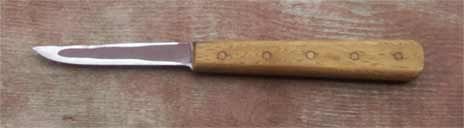

1) 1095 paring knife, custom, Alvin Johnston :
The black is just a marker to show the primary grind, it isn't a coating. This is 66 HRC, high hollow grind, sharpened flat to the stone, edge at 3-5 degrees per side. It is one of, if not the best cutting blades I have. It makes a SAK look like a crude wedge in comparison. The hardness not only makes it able to cut materials softer blades can not, it also gives it very high edge retention and ease of sharpening. It was supposed to be a paring knife but I use it as general utility knife and have done everything up to and including cutting up sods and digging with it. I don't have anything negative to say about it aside from the fact that it isn't M2 at 65 HRC.
