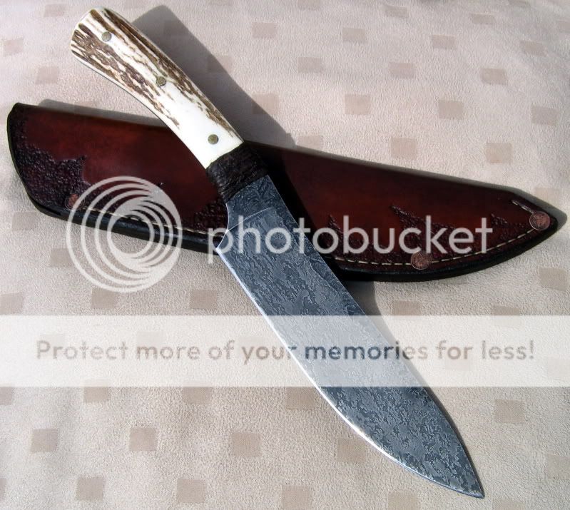

I chose to get back to my roots on this one. As a custom maker, I tend to always wanna try something new. As we all know, new doesn't always mean it'll work. So I reached back and pulled heavily from my first design.... when I was a user trying to make the perfect camp knife.
This is the very first knife I ever made... I used it for 3yrs. The handle was off set from the blade so that the centre of it was inline with the spine of the knife. This allowed me to get behind the blade without over-extending my thumb. It also gave my fingers some clearance when cutting on a flat surface like a board or a log...
This is the original sketch of the contest knife. I took on the same handle config as my first knife and gave it a larger blade for chopping. The blade is actually upswept with a small drop point. I has some belly to it and the drop makes for easier skinning. I decided against the "bearing block" divot in the handle scale as they tend to burn out after time. I also removed the lanyard tube. In all my years of bushcrafting, I have never used a lanyard on a beltknife...
The final knife turned out very similar to the sketch other than the blade is a bit wider... The balance poing is just infront of the hemp wrap.
