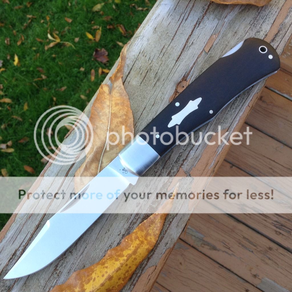

My Ebony Wilfred Lockback arrived today. Until I can put my thoughts together on this one, here are some quick pics,
Those look so friggin nice Jamie. I love the radiused spine and I'd love to get one but I'm not a fan of a pocket knife much over 4" closed.

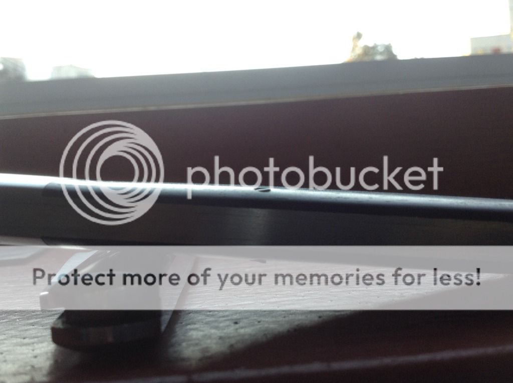

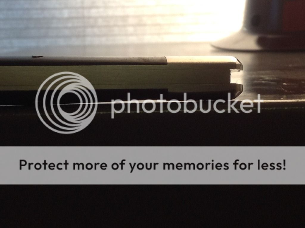

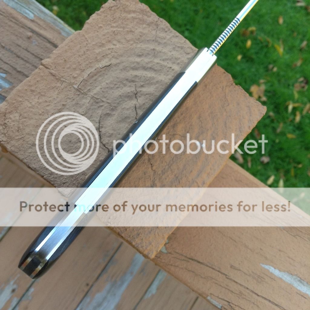

No question, 4 1/2" is a big knife. Even when it is as thin as this one. The radiused spine and jimping are fantastic. Actually there is nothing to fault on the blade at all, grinds are even and fairly thin, nice taper to a thin point and it is dead centered. Lock is solid and the blade will free drop when the lock is released, albeit with a little stick which should go away. Construction is tight with no gaps on the spine along the lockbar. That's the good part.
The bad really centers around the covers. The mark side cover is pulled away from the scale and both sides have prominent coarse grit scratches and we're not properly finished. I could live with those Hawks as the gap would eventually fill with gook and I could easily finish sand the covers and lightly buff. Issues of a more serious nature involve very poor cover shaping with a noticeable depression between the front pins and the bolsters. Most troubling of all is that the pins were supposed to be ground flush during finishing but somehow they now protrude on the back edge of the pin and are recessed slightly toward the front?? It almost appears as the pin has bent under the stress of the lockbar? Refer to the spine shot above where you can see the pin appearing somewhat distorted. This one unfortunately will need to be returned. I might be willing to accept these issues and fix what I could on $50 knife. This is a long way from a $50 knife.

Finish wise, it is very shoddy. Here is a better pic of the center pin.
It's a nice looking pattern that I think will have appeal to a lot of folks. It's unfortunate that there were some issues but hopefully Case will take good care of you. I know that you are aware that wood handle materials can shift a bit. And the gap between the liner may have occurred after manufacturing. The cover pins don't reach that spot. The center pin is odd to me. I thought the covers were shaped by grinding so I'm not sure how that pin escaped without being ground flush.
