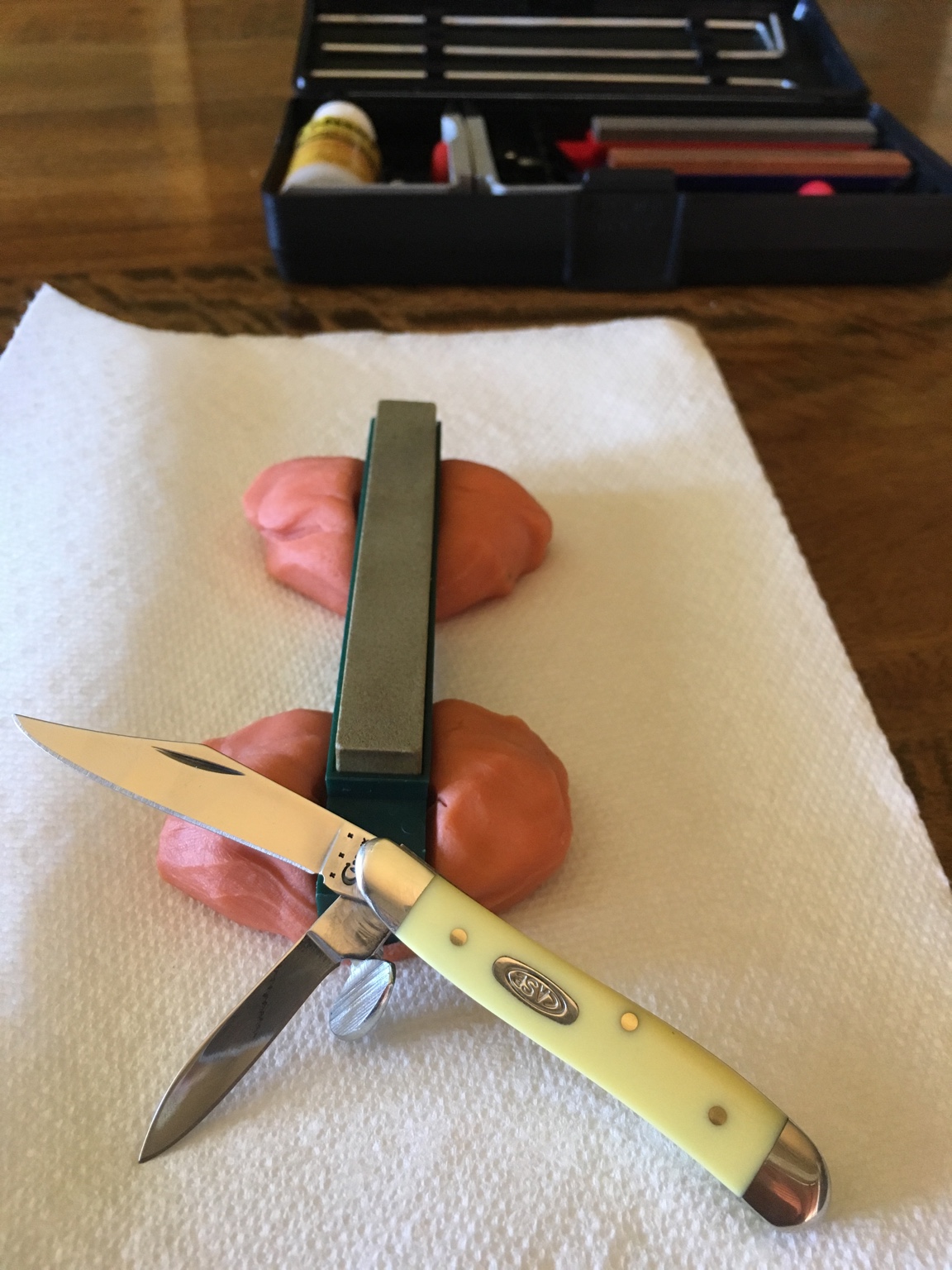

Hey guys!
Today I received my Case Peanut CV in yellow delrin. Beautiful knife, clip blade is favouring a side a bit but there doesn't appear to be any rubbing.
But, I was quite disappointed with the edge after unboxing.. I read through the "cult of peanut" thread and many people said that they only needed to strop their peanut and it was like a razor blade.
Welp, I tried that. Nothing. I tried the ceramic mug, I tried frosted part of a car window nothing. Still nothing, I just can't seem to develop an edge on this small knife.
I chase the burr back and forth and can feel the burr form - I can't even it out.
So as a last ditch attempt, I used my only sharpening system Lansky, and made a ghetto sharpening stone (see photo). Same issue continuously.
I think the edge needs to be re-profiled to 30 degrees but it is to small of a blade to use with my Lansky system.
Any tips on how to make the Lansky work with this small knife or how to obtain an edge?
Should I just invest in some stones and learn to freehand or a Spyderco Sharpmaker?
- Ryan
Yes that is my nieces play-doh holding the stone steady.

They can be tricky to sharpen, possibly different stones might help, I use some shaptons and some chosera's that work great, but you should be able to use just about anything, unless the heat treat is off on that one for some reason.

Why not bolt it into the lansky and get it all set up nicely?
Well I wish it were this easy but here's the problem with that!
By the time you bolt it in with the Lansky and get the blade in there all snug, your only left with maybe a cm and 1/2 of edge to work with. The stone hits the clamp.
I remember sharpening a peanut on the Lansky- just had to use a higher angle but it cleared the clamp. And fine because the blade stock is so thin. I'd be happy to sharpen it for you.

I meant that I wouldn't go too much by what other folks say since opinions vary. Some folks don't sharpen their new GEC knives. To me, the factory edge on a GEC knife is unusable unless you are just spreading butter with the knife. ;) Some people take things to the opposite extreme. Their knives are so sharp that they will cut your eyeball if you just look at the edge. :p What works for you is what matters. I use and would recommend the DMT continuous diamond stones.
For what you describe it is possible that the edge is a little over heated from factory sharpening, becoming a little softer due to heat.
What I'll do is cut into the stone to get rid of fatigued metal(I'm not usually a fan of this method as a common technique but I believe here could work well). Then take a medium diamond stone or similar (Norton India, soft Arkansas,etc. Around 400-600 grit hit the sweet spot for me) make contact with the bevel and work it in small circles until you have a burr, flip and do the same. Ten alternating passes with very light pressure afterwards and a little stropping should get you to a clean edge.
I find that with the small dimension of the handle it's difficult to me to hold the angle with the usual bench stone stroke and prefer to hold the stone in one hand and the knife on the other
Hope it helps

Ding ding! We have a winner! :thumbup::thumbup:
Lute is correct, use the small circle method on a little peanut size knife. The setups and gizmo's are not going to work as the knife is too small. Hold the knife in your right hand, if you are right handed, and the stone in your left. Start all the way back by the kick, and start honing in a small circle at about the angle you want. Work your way up to the point of the blade, all the while honing in a small overlapping circle pattern. Do not break contact with the stone because this will cage the angle. Take at least a full minute to get to the point of the blade. Repeat on the other side. Do this until shape. It may help to use a dry erase marker to darken the edges so you can see how your doing.
As far as angle, do not get obsessive over it, it won't make any difference that you can see in real world use. For about the right angle, hold the knife like you're going to saw the stone in half. This is 90 degrees. Lower this angle about half by eyeball. This will put you at about 45 degrees. Now lower that again by half and this is about where your pocket knife blade will be. Start honing there in the small overlapping circles. Don't obsess over a few degrees. It won't matter if it's 22 degrees or 25 degrees, the edge will be sharp if you learn to be consistent.
Free hand sharpening is not rocket science, and it's easy to do once you get the feel for it. The object of the small circle methods it holds a more consistent angle while sharpening because the blade is in constant contact with the sharpening medium no matter if its an Arkansas stone, diamond, or silica stone. No matter. This is actually better with small knives like peanuts and 58mm SAK's.
The circular or elliptical grinding method, along the lines of what's been mentioned previously by lutejones and Carl (jackknife), is what I'd do with a Peanut (and have done with mine). I like to use a 'Fine' diamond hone for it; anything coarser than that isn't needed, and it'll also risk really chewing up the thin edge on that small blade. Also more challenging to control the angle consistently with a coarser grit, as the edge will really bite the hone, making angle control difficult. A Fine diamond (~600 or so; my favorite is DMT's Fine) works very fast on these simple steels, and leaves a finer finish at the same time, worthy of a great working edge in it's own right. The speed of diamond works in favor of reshaping the edge with fewer strokes, which also minimizes errors brought on by fatigue, as might happen with a less aggressive stone that works much more slowly. For additional smoothness and control, I've grown to like using a little bit of mineral oil on the hone as well (yes, oil works very well on diamond hones).
Once better edge geometry is set, maintenance sharpening gets a LOT easier on most any stone, as the wider bevels set by rebevelling work much better to stabilize the angle. I'd recommend 30° inclusive or narrower; Case suggests anything from 20-30° inclusive.
BTW, the circular method will obviously be a bit easier on a hone that affords some width to accomodate it. Lansky's narrow hones (1/2" wide) can make that a bit difficult; I've liked using DMT's 'credit card' hones, or their larger 6" x 2" Dia-Sharp hone. Both are the 'continuous surface' diamond coverage, which also lends a little more smoothness and control to the process.
