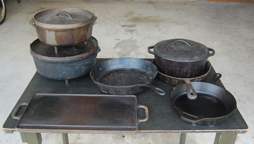

Youse guys are always getting me in trouble. I was looking over this thread and Mrs. weaponeer peeked over my shoulder. She got interested and we went through the whole darn thread and she did a lot of ooooohhhs and aaaahhhhs. Then she asks, "Where's all our old cast iron stuff?" She has a Lodge cast iron skillet that she uses a lot, but remembered we used to have a lot of cast iron from our old camping days. So I have to go out to the shed and poke through all the old camping supplies and prepper stuff. Lo and behold, I found it!
Other than the skillet in the lower right, none of them have been used in years. It's time for some rehab and reseasoning. Just what I need, another project!
I think I will do the big skillets and the grill first, and then the dutch ovens. Wifey promises that if I clean'em up, she'll cook something good. Works for me.
