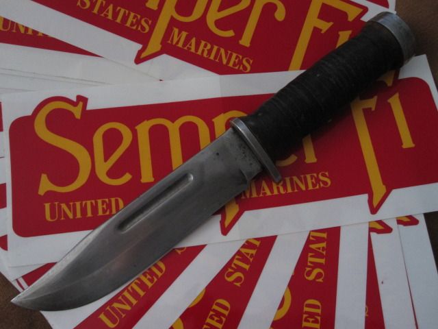

When you see a lot of Cattaraugus Q225 Knives their Handles have a Indention on most of their leather stacked handles as if their handles had a rope or cord tide around them instead of wearing them on their belts, is this how a majority of the soldiers had secured them or just a certain platoon or company depending on where they were stationed, because I have seen some without the markings but far and few in-between ~ ?
ive seen some of the handles wrapped in leather cordage over the stacked handles, and some wrapped in it to replace broken or missing leather discs.. i would guess that the ones with indentations were wrapped for extra grip, as oiled leather discs get a tad slippery when wet.
Those indents in the leather were caused by wire used to secure the knives to the outside of wooden crates.
The Cattaraugus Q225 was a Quartermaster's knife, not an issue combat knife. Surplus ones were marketed after the war as "Marine Corp. Commando Knives" to sell them off to the public.
I'm pretty sure they were sold as the cattaraugus commando ( I've seen ww2 era advertisement pages for them ), and the the quartermaster thing is just a theory / myth.
Could that wear in the handle actually be from the retention strap ?

Here my first of several Cat 225Q knives.
I encountered this at a local small gun show years ago.
A stack of used knives had this one forlornly peeking out at the bottom of the stack.
I asked to handle it and got to check out the 225.
It was dusty and slightly pitted and with some other indeterminable patina and a not original sheath.
It looked pretty dirty and nasty truth be told.
I left it at the table and left the show but couldnt get it out of my head.
I called a friend with a stall at the show and had him make the owner of the knife an offer, which was accepted.
I got it for a silly low amount back then. They can still be had for an okay price but prices on the 'bay have risen and some are absolutely priced ridiculously high.
The Cat cleaned up very well and much to my surprise, there was basically a new knife with completely unaltered lines under all the grime and surface patina.
Many of the Cats have been used, abused and sharpened all to heck, so this was a nice surprise.
Now, after having purchased several of these, this the first one is still the one in the best condition of the handful of Cattaraugus 225Q knives, that I own. It is and always will be, one of my favorite knives.
That's sure a beauty. Mine isn't as pointy and the swedge isn't as crisp. I've wanted to fix those things but I'm reluctant to take the "experience" out of it. Picked it up at an antique store for $45, if I recall correctly, about 4-5 years ago. :love_heart:
No, indents were made at the factory. But new theory - THAT one I hadnt heard before (!!). How on earth did you come up with that one?

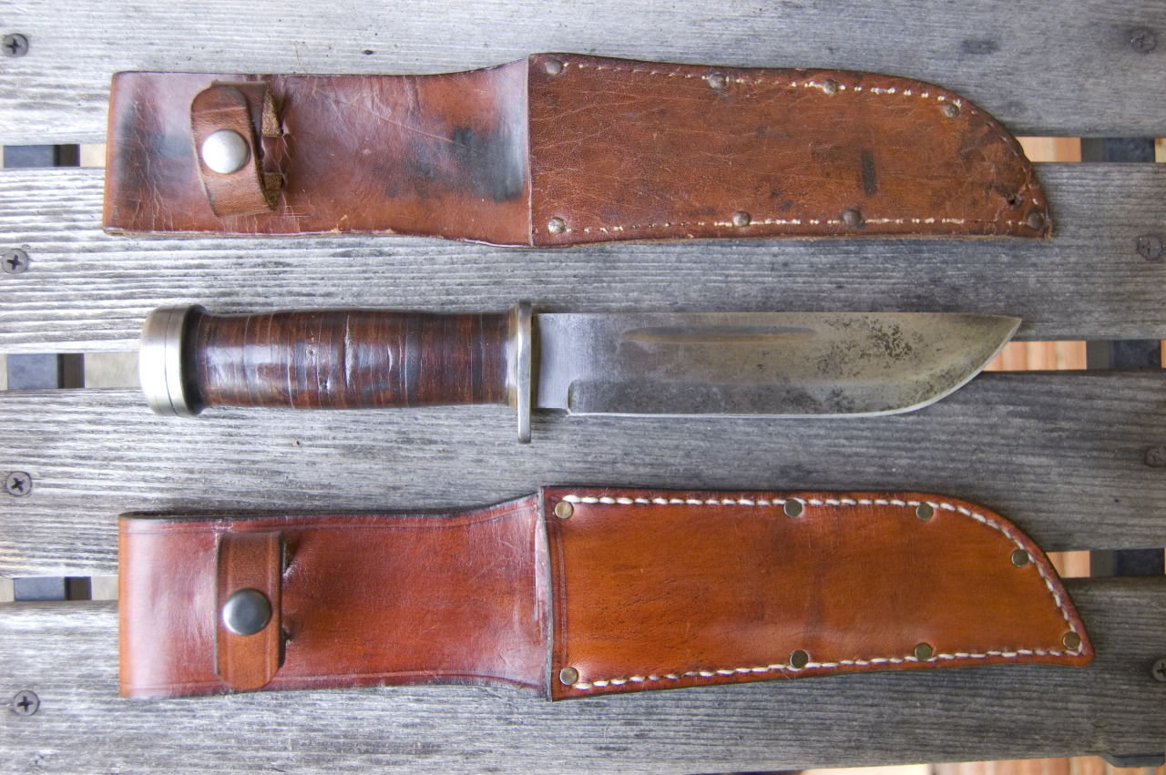

I need to take some better pictures, but here is mine in its original sheath, a gift to me from the estate of my mother-in-law's father:

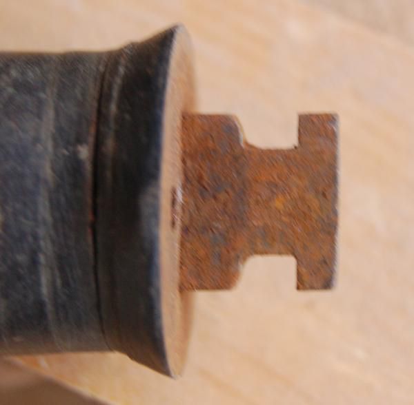

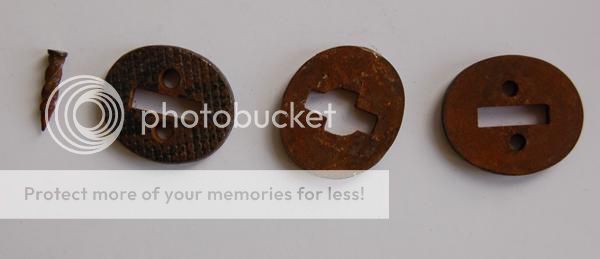

For anyone interested, here's some pictures of the details of the pommel construction for the Cat 225Q.
The middle disc clears the top of the tang and is rotated on the notch to lock it to the tang. The top piece is added and the two square shank twisted nails are hammered in to lock the three pieces of the pommel together.
