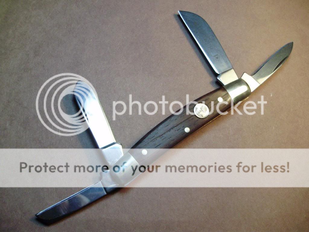

That's an interesting point. I do most carving with a straight edge, but there are a few things that call for a different shape. The Boker Carver's Congress was designed for wood carving, with a spey-like blade for scooped cuts, and if I ever try to carve a spoon, I imagine I'd need something like that.
While I'm posting pictures, here's a lizard I carved mostly using a #26 with wharncliffe and coping, but I used a few other tools as well.
Ah, yes, the Böker Carver is an excellent counter example!

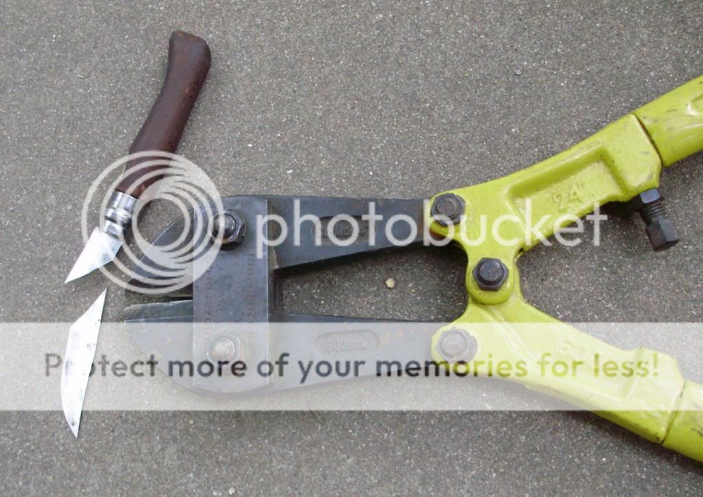

Just for laughs though, here's an idea of my amateur knife-modding "skills"
Don't try this at home, kids. And if you do, be sure to put a sack over the blade before you snap it. The end of that blade flew off my porch, 30 feet across the yard into the street! :eek: :D
Yowza, you don't mess around, Rachel!! :eek: I modified the handle on an Opinel #6 last week, and discovered that I'll have to reshape the blade to get the tip back into the new handle. My plan was to try to do it using a file, but now I'm wondering what would happen if I had access to a bolt cutter ... :confused:

Thanks for posting a pic of your Böker carver congress, Rachel; I was hoping this thread would get an example of that model eventually. :cool: And I enjoyed seeing your lizard (and GEC 26) again! :thumbup:

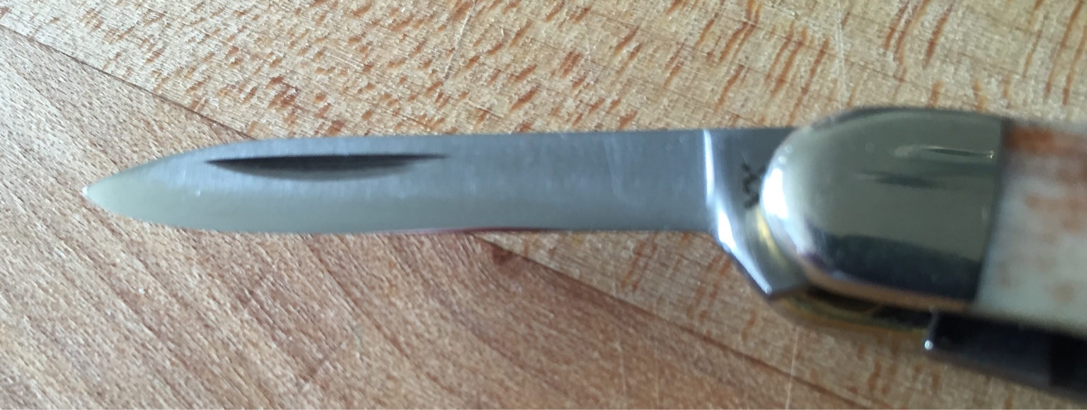

Tying both of the sections I quoted together, I sharpen my whittling blades at around 10-11 degrees per side, which is exactly in the range you're talking about. I haven't had any issues with chipping or other ill effects.
And, I've also seen the recommendation to knock down the shoulders of the edge. I used sand paper on a mousepad to give a convex edge to the blades on my Case Seahorse Whittler. I was disappointed with the factory edge. But, once I re-profiled down to 10 DPS and then gave the convex treatment, those thin little blades carve up a storm!

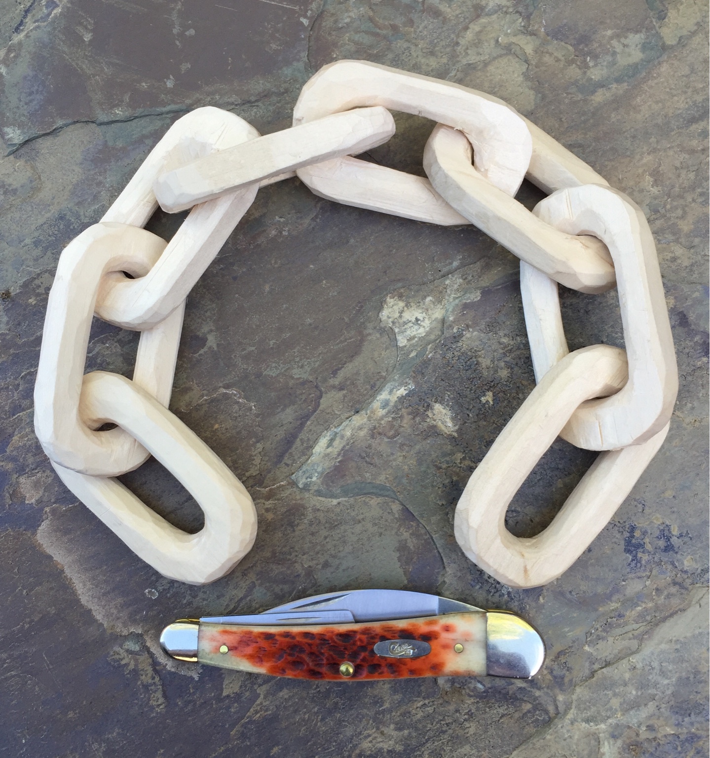

Here is my Seahorse posing with the most recent project I whittled with it:
This is a not-so-good close-up of the pen blade which I hope gives at least an idea of what I was describing:
As to 20-24 degrees inclusive full flat grind, does the trigonometry work out on that? I would think you'd need a secondary bevel to bring the edge up to that degree range unless the blades are very narrow. But it may be that I don't understand what exactly is meant by a full flat grind. I must admit to not being fully up on my blade grind terminology... More things to learn! :)
