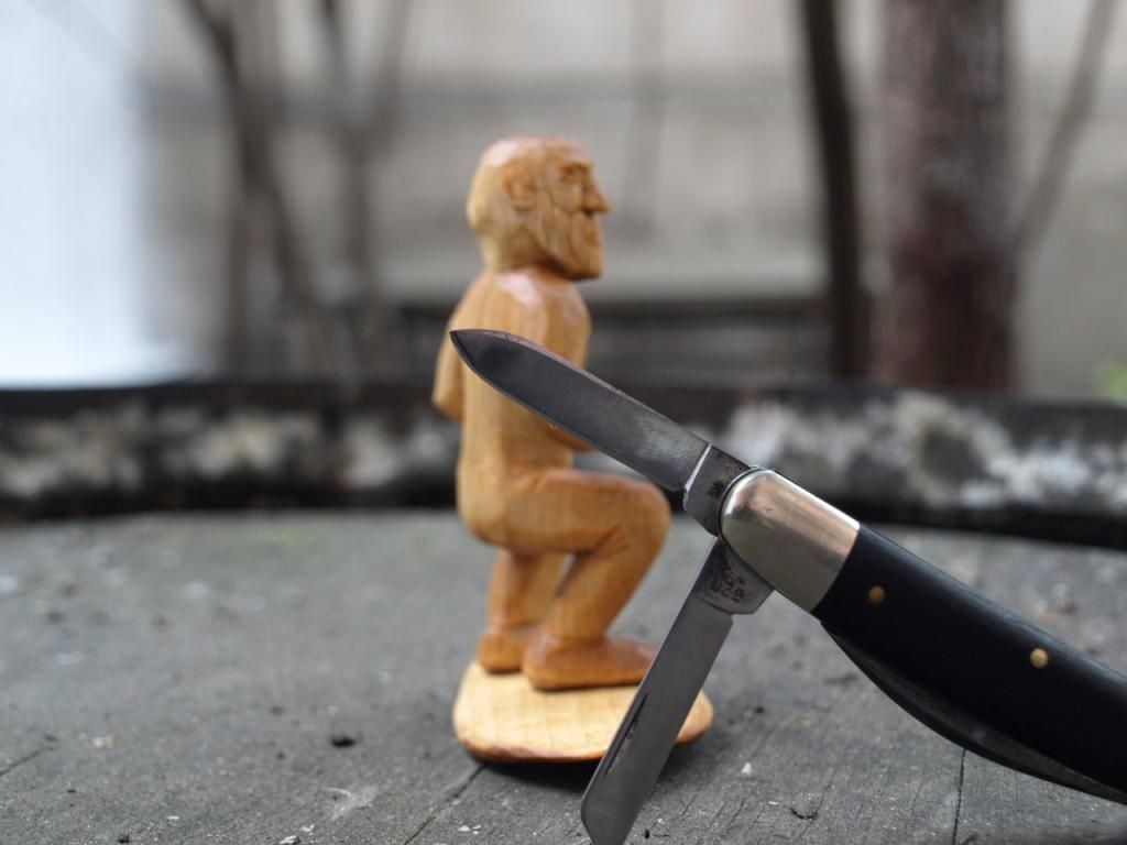

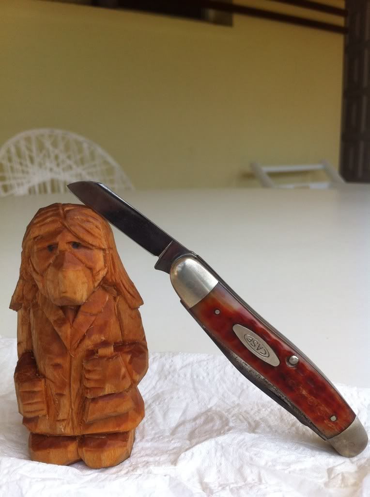

Hey guys it's been a while only reading due to lack of time.
Anyway here are the two I use the most The case whittler it's a wonderful general purpose carving knife, while the other one an old Solingen without markings, is better for smaller carving and fine detail, I've modified the point to allow tight curves to be carved.
these next two where the ones I began with
Numerous times I have fantasised about selling all my knives and have a dedicated whittler made for me.
Around 3 5/8" spear main blade sitting inside the frame(or Long clip point like case 6318) As a general purpose blade, then two secondaries both scimitar shaped one around 1 3/4" for roughing out with a thicker grind and one 1" fine detail blade maybe with extended tang to reach into tight spots, well... Dreaming is free, isn't it?
