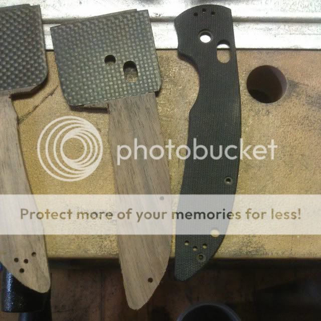

What do you guys use to cut the pivot pin holes, axis holes, and the spring recess so cleanly? I have been trying to make some scales for my 523, my 581, and have ruined some otherwise 4.0 scales. Lol. These materials are expensive too. Help!
I don't have counterbores so I just use a drill. They come off my drill press clean but I have to be real careful that the bit is centered in the hole for the pivot initially.
A drill press; with step bits for the pivot and screw holes.
A drill press; with standard bits for the axis hole.
A dremel for the spring recess.
Sweet! Thanks for the info. I have a decent step bit, and a brand new dremel 4000. I guess I'll have to go get a press adaptor for the dremel and I'll be good to go. I had been filing the cuts out with some jeweler's files, but that takes forever. Ha!

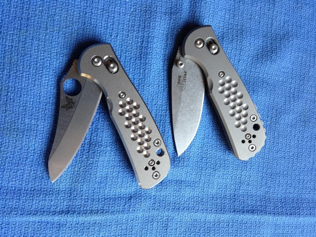

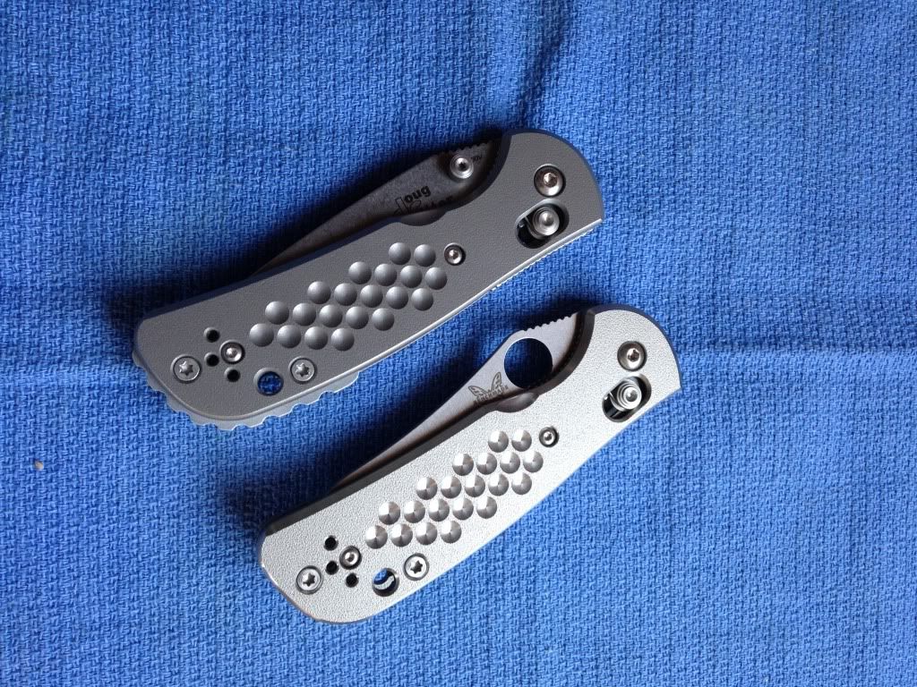

New Ti Wilkins Grip scales next to a Swimming Pool Green set:
Yep, that's IT! NOYCE!
Thanks!

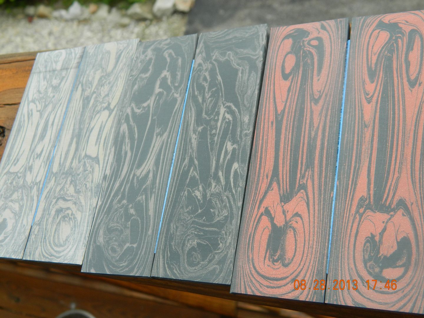

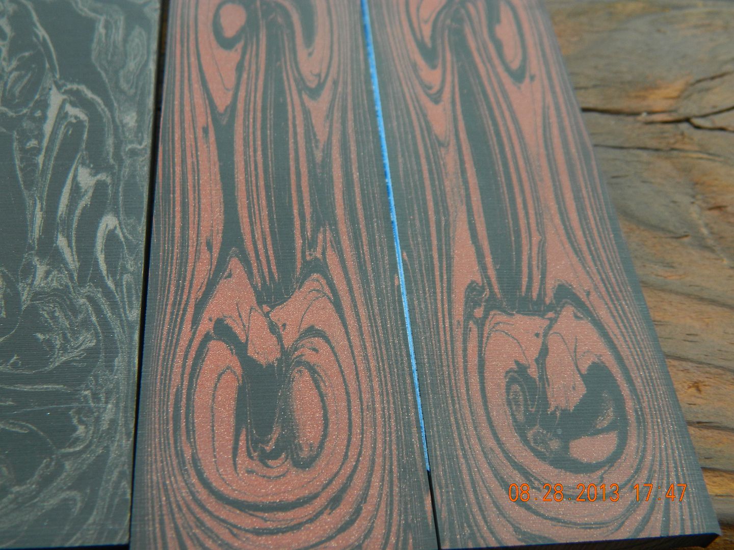

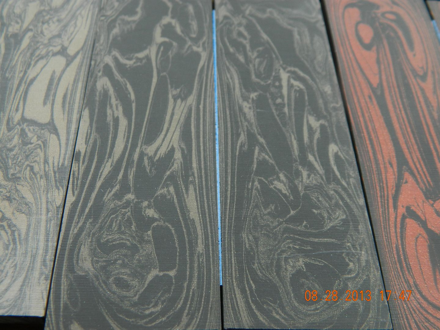

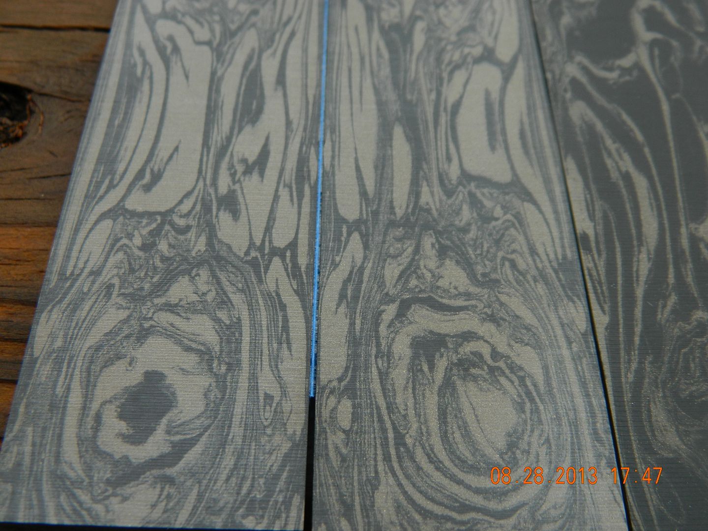

I got some new stuff in!
These are actually metal composites!
Black And Red Mokume, Black & Gold Mokume and Black Lava And Gold Bronze Mokume.
I can not wait to dig into this stuff!
