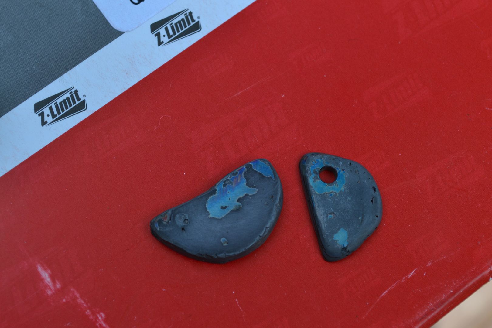

Yesterday I got in from working on the folders around 6 and decided to make Mokume! lol I broke out the sandpaper, cleaned up my materials and finally got a good weld!!!! It was awesome, I was not getting my metals hot enough before, a change in firebrick made the difference.
I made a liver of sulphur solution and put a cool patina on the mokume, the copper is black with blue/rainbow highlights on the nickle.

Xander - I just sanded my stock down (75 cents worth, lol!!!) with some 320 paper and then cleaned the heck out of it... used a Mapp gas torch (pretty decent one made for soft glass) and put my stack on some soft firebrick.
I had been using hard fire brick and I think the soft made the difference. More heat! I was able to get my whole stack way past red hot.
I thought seeing the colors dance around on my metal was enough heat but I actually saw the metal "sweat" this time, it was awesome! one light whack with my tons was all it needed to weld, I may have been on the hot side as it felt like I was hitting liquid and some nickle came out. I could see the nickle sweat to the edge as I moved the heat around...
I bet you need more heat, I didn't get the soot I had been getting before that I had guessed was a flux or environmental (flame wise) condition.
I'm happier with the patina than the actual mokume! I'll press on with both, I may buy some steel plates next.
Sweet stuff. I took a stack of $1.50 last time I tried. I did it in the 2B forge, gotta be careful on that first hammer blow, molten metal goes flying! I need to pick up some borax for flux and give it another go. I guess I could try hot vinegar for pickle to clean them first. I guess with a proper clamp you don't even need to press or hit thm to weld, they expand so much during heat that they will weld themselves, but the clamp needs to be über tight.

Thanks! It had a traditional look before the patina too, multi etch also seemed to be a really nice look.
Yeah the forge is different, I want to try the kiln next. That is a decent investment so I will go all out... 1" plates
..I almost tried a borax slurry.
You might be able to buy packs of powdered pickle (add distilled water) if you have a local jewelry supply, of course storage for the liquid is the real issue. Cheap crockpot and you're good to go! Check monsterslayer.com for pickle online, I guess they can ship it. They have a bunch of different fluxes too...
I just used soap/water then simple green then windex... all rinsed with distilled water then cleaned with acetone.

Cool, thanx! I'm not too keen on having a hot pot of caustic chemicals emitting fumes in my poorly ventilated shop, I'll go more normal routes. Supposedly the hot whie vinegar works well enough for soldering, and that should be clean enough for welding.
Oversize steel plates, say 3/8" thick with holes drilled in the corners for slip fit of 1/4-20 SS bolts and a nut on the other side. Clamp your stack down as tight as possible, then a little more. I believe you need to bring it up to 1600*F and hold it for a while. The internal pressures of the expanding metals will be enough to weld. I know jewelers say its a 6-8 hour process in the kiln, but I dont remember the exact times at temp or if ramps are needed.
