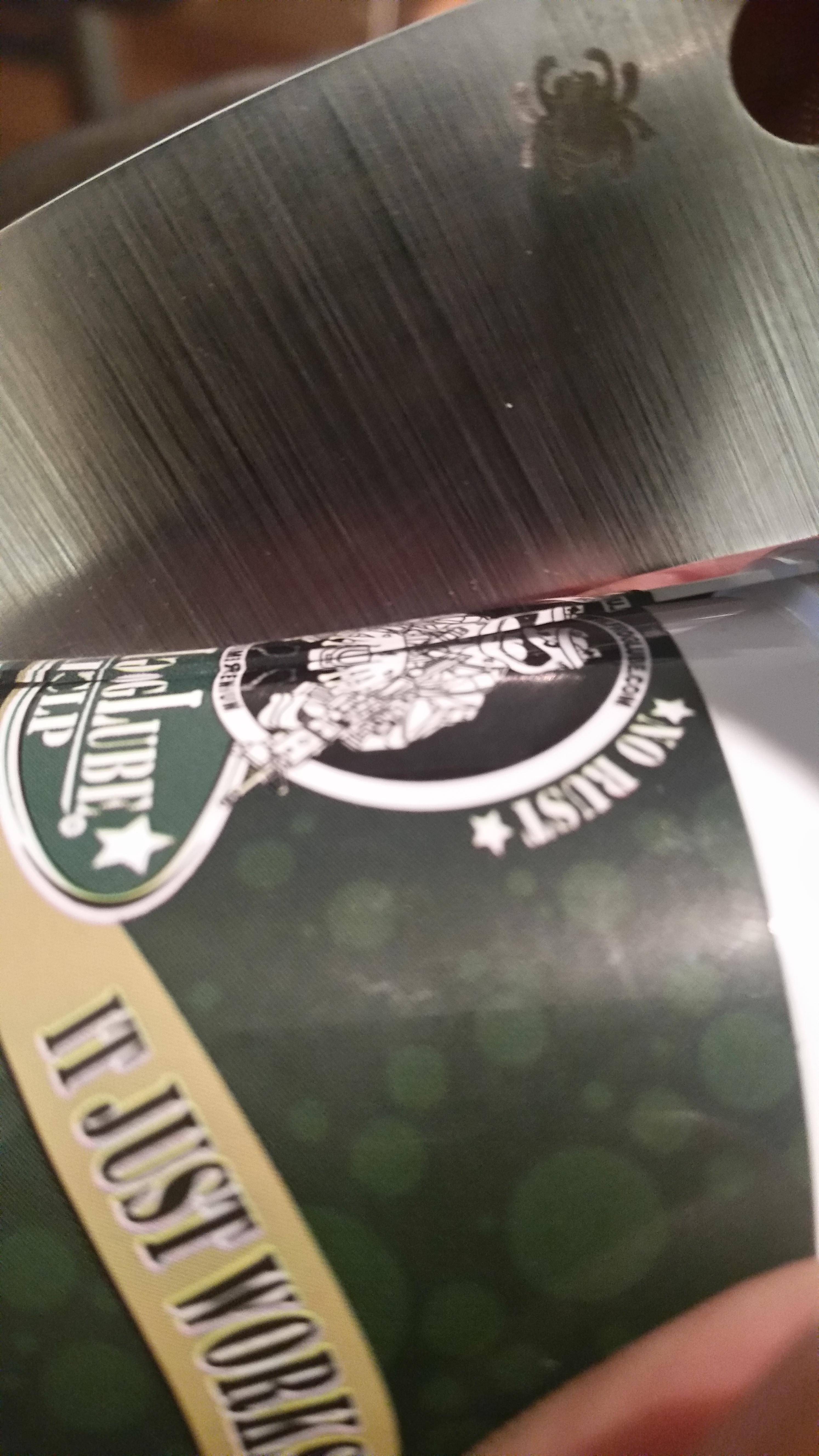

Here are two knives I used the congress stones on. Started with low grit ruby stones, followed by the moldmasters up to 400 grit, skipped the 600 because of how bad it disintegrates, went to the 800 grit super soft and finished with the highest grit I can find on their site which is 1200 grit super soft. I followed up with the same strops. If you look closely you can see these are cloudier than the edges formed from the ADAEE stones. Prior to the strops it's way more obvious. The polishing is really done with the strops. Off of the 1200 grit stones there's almost no reflection, off of the 2000 grit ADAEE stones there's already a slight mirror, albeit kind of rough. The real results show after the polishing is done on the strops, as seen in the pictures.

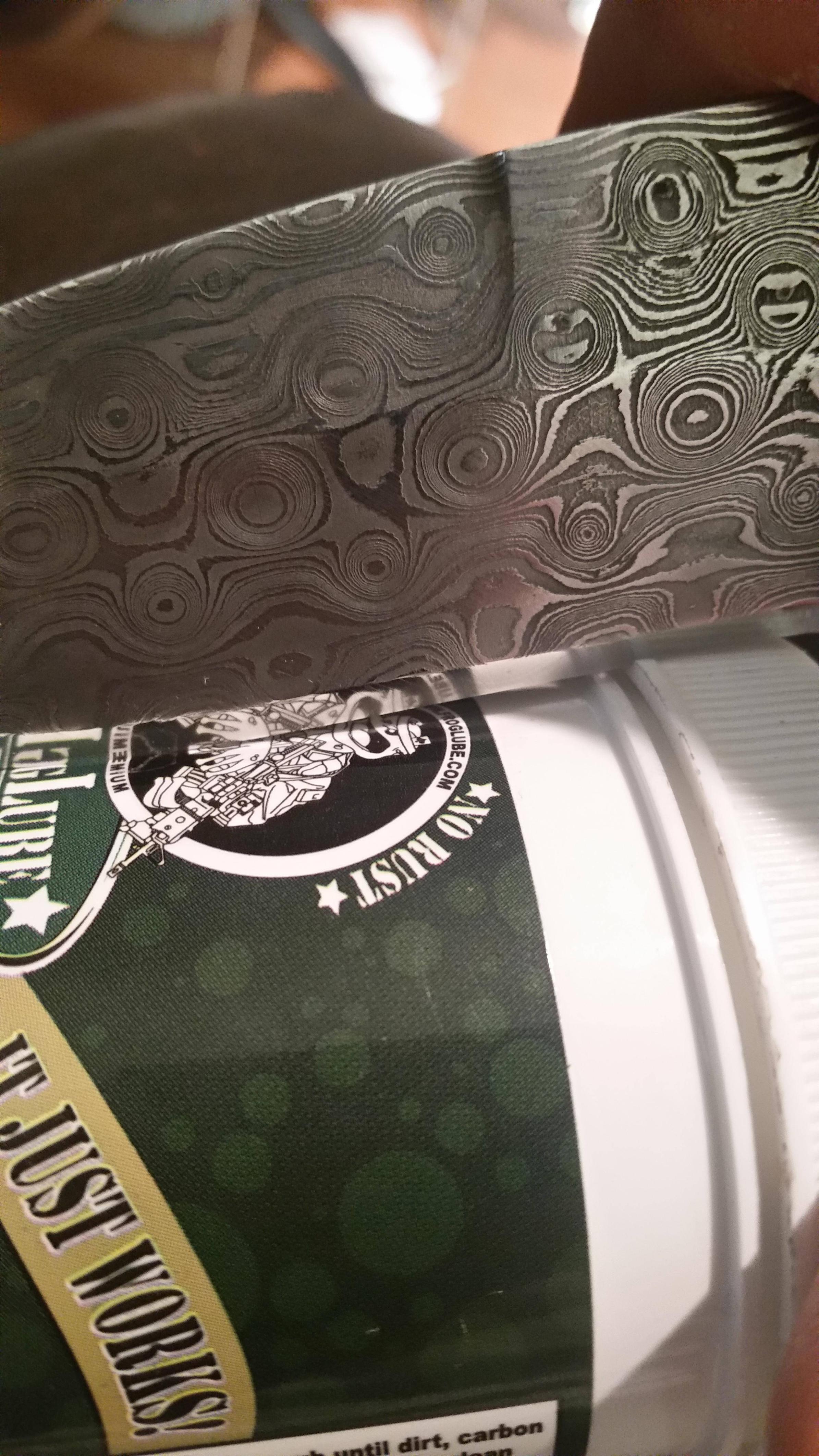

And again the ADAEE results for comparison
On the second photo I reprofiled that knife down to 8 degrees per side and followed up with a relief bevel at about 13 degrees per side which is why the bevel looks weird. I've been sharpening on that relief bevel for several months now so it's pretty well the whole bevel now.
The 8 degree bevel was set with the ADAEE stones and the 13 degree relief bevel was most recently sharpened with the congress stones. You can see the difference between the the two stones on that one knife edge if you blow the photo up and look close, especially by the word "lube" on the label.
