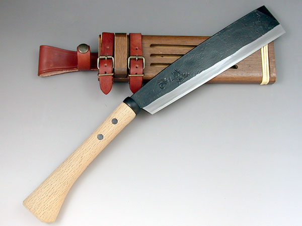

Asymmetrically ground agricultural choppers are much more common than weapons. Even in Japan.

So let me get this straight you can NOT tell me what countries are using these chisel grind swords since the "beginning" and are currently still using? lol you make a bold statement and have zero info to back it up. I asked you to not be vague but clearly you dont know what your taking about. come back when you have some real info thanks. also the item you posted a picture of is NOT a sword lol

When you are slicing or cutting a piece off a larger piece, a chisel grind will be more efficient. Deli slicers, bulk paper cutters, are chisel ground and their application is where "parasitic drag" comes into play in the fact that only one side of the blade exerts force to part the material. The flat side doesn't push anything away, minimizing "parasitic drag". Slice a piece of sashimi from a larger piece of fish, and you'll find that a straighter cut is made with less effort when using a chisel ground yanagi ba than a v-ground slicer.
However, if you want to split firewood, whittle, chop vegetables, etc. the v-grind works great.
Precisely. Paring cuts from a pre-determined side --> chisel grind is best. Deep cuts in material or when cuts must be made directionally at-will --> symmetrical grind is best.
