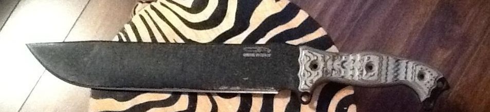

Comparison pic from few months ago:
hognose war sword
