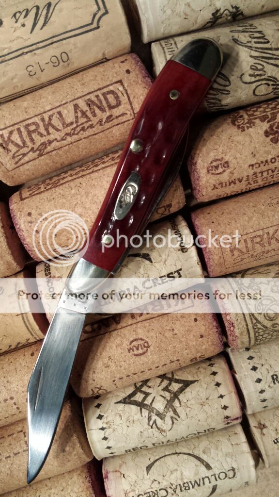

Enter the first of two knives, a new Peanut in Corn Cob Jigged Red Bone. I looked at the pics before buying and they looked alright in the pictures, but upon receiving the knife, there were some a little light colored areas. It wasn't terrible, but I was a little disappointed. I even got Stainless Steel over CV for the sake of good looking bone and didn't get it. :(

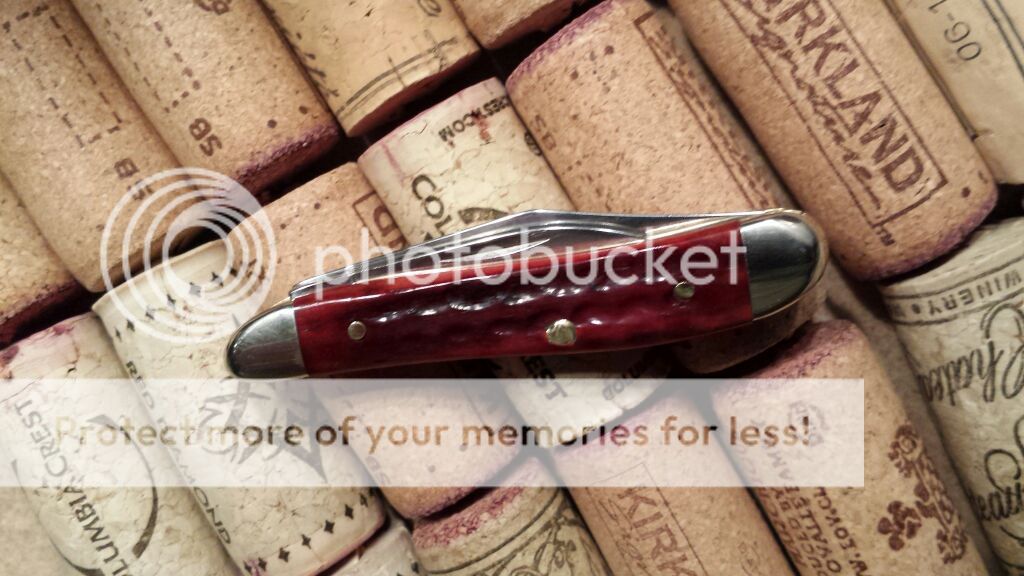

Enter a cup of coffee. I forgot my second cup this morning on the counter when I went out to work in the shop. It was cold, by the time I remembered. That cup sat there all day and when I got the knife in the mail and saw that the bone was not exactly what I wanted, I dropped the knife in (after cleaning vigorously with alcohol) . I left it there for a few hours. It did a nice job with the bone. I should have taken before and after, but I didn't.
Much better.

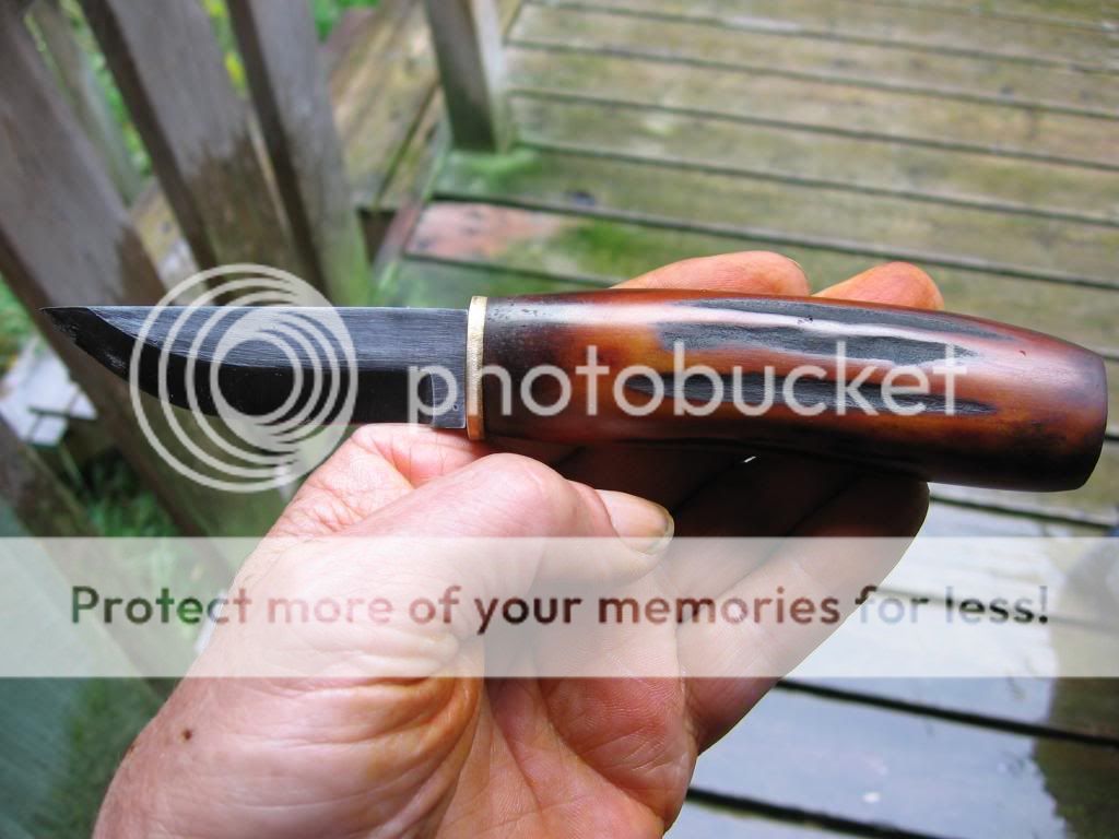

Fiebings leather dye. One coat,before and after.

Fiebings leather dye is either spirit based or oil based.I find it best to use some 400 grit black sand paper to break the surface of new knives.
Tandys carries fiebings and applicators, or a watercolour art brush works too. Spirit based dye sinks in pretty well and dries quickly
and oil dye will lay down in top if you want to mess around. It a great dye for white bone.
The handle in the pics was pretty close to pure white after I ground it smooth, this is a few coats. The stag was sanded to 1500 grit befor dying.
