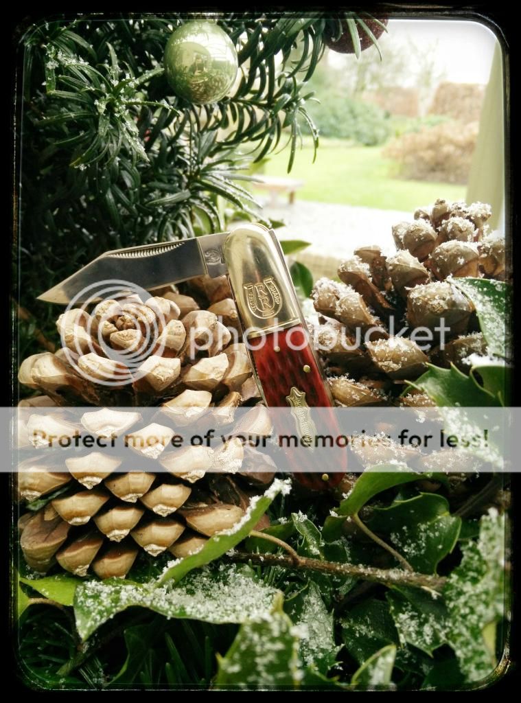

I've been dyeing bone again. This one started out red pocket worn, with a lot of pink and "white frosting".
Kinda looks like old case red bone now IMO.
Hmm. I need to dye a sheath anyway and like a dark brown. I may have to order some Fiebings anyway. I've got two twisted bone tobacco Rough Riders that are more like oatmeal while the other two are just about right. I'm wondering what would be a good dye bring the brown down in those RRs. I may try a strong tea soak first though. I'll be needing to match the sheath to a holster.
Those mahogany dyed Case go from bleh to WOW. Those after shots look like the old Case we know and love.

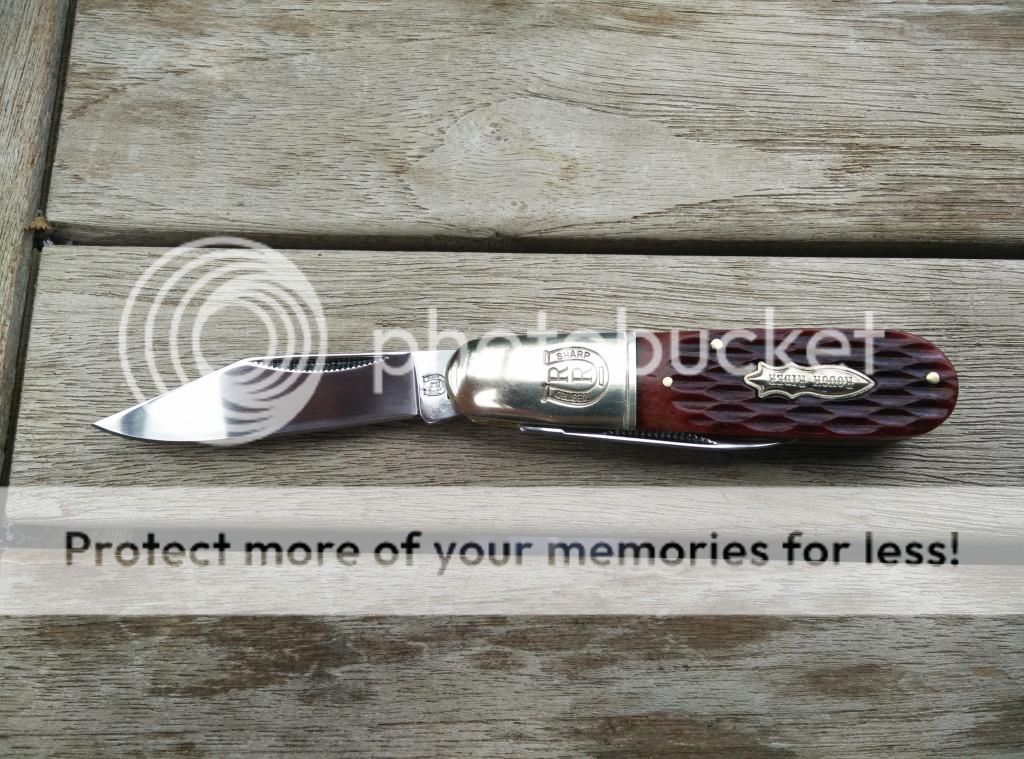

I've got a red bone RR Barlow in a coffee/tea mix as we speak. The main body was nice and red, but that quickly turned to almost white near the bolsters. Didn't like it, so I'm aiming for a deeper colour. Thanks a lot for the info in this thread, it was a good read so far and I'm looking forward to others' results.

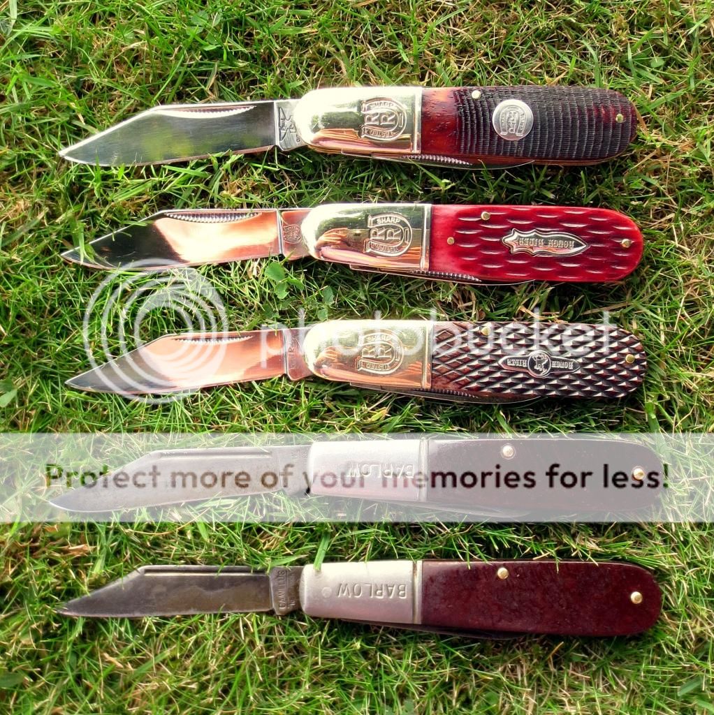

I'm back with an update as well.
Before, my RR Barlow was somewhat between red and pinkish. It didn't annoy me or anything but I much prefer the colouring of my saw cut and jigged bone RR Barlows.
Hence, this guy got a coffee and tea treatment in order to darken things up a bit.
Before...
After
Now it's more of an amber/red/brownish rather than red/pinkish. I love it a good deal more. Yay!
