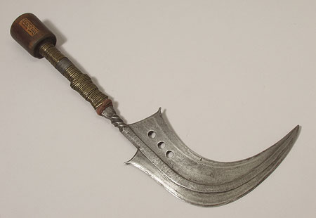

Here's an "iron" Mangbetu blade with some nice cold forged details, planishing and a work hardened edge... pretty cool. :)
Mangbetu sickle knife:
I suspect they did some hot work on the blank, but still mostly cold forging.
That's pretty slick. Sometimes you just have to go with what you've got, and fire isnt one in the got column.
