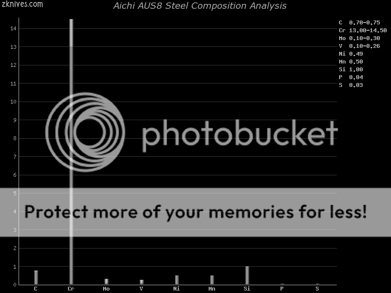

First, AUS8's composition:
From the same source:
"AUS8(Aichi) - Aichi steel. Sometimes referred as A8, which isn't correct. More often it's called 8A, which is a common abbreviation. Similar to 440B steel. AUS8A is the same steel, except it's annealed. Apparently A stands for Annealed."

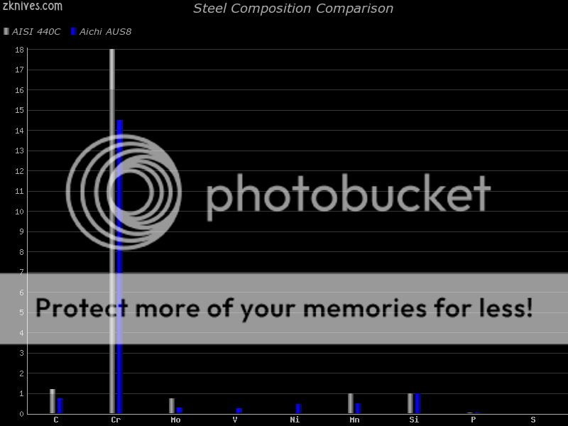

Next, 440C, compared to that chart:
You can clearly see here, not only is the amount of Chromium much higher, the Carbon is as well. Though these differences seem minute, you will often find that it does not take a large difference in the amounts in relative percent to make a difference in the steel's performance. Also, you will find that Carbon is a key element, along with other metals, in forming carbides. Without those carbides, the majority of the steel's properties will not be at the desired level, primarily cutting performance.
You will also note that AUS8 also has much more Molybdenum in the matrix of the steel, which aids in making carbides, and allows Chromium to function more efficiently at preventing corrosion, since Chromium that is held in the carbides of the steel does not actively prevent corrosion.
So, as we have actively proven that AUS8 is NOT an equivalent to 440C, most of your argument becomes unsound.

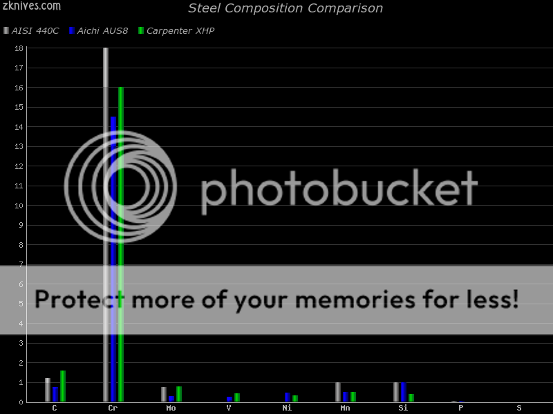

Lastly, let's compare CTS-XHP, 440C, and Aus8 all together:
Now the differences become MUCH more apparent between all three of these steels.
This is a fairly common description of CTS-XHP:
"CTS-XHP is an air hardening, high carbon, high chromium, corrosion resistant alloy which can be described as either a high hardness Type 440C stainless steel or a corrosion resistant D2 tool steel. Possesses corrosion resistance equivalent to Type 440C stainless but can attain a maximum hardness of 64 HRC, approaching that of D2 tool steel."
So it is not AUS8 that is a comparison to 440C, but in fact XHP. So, you have, in fact, given an argument for why this steel IS as good as it is, with your praise of 440C. If we take your arguments for why 440C is a good steel, and replace your false statement that AUS8 is an analog to 440C with the truth; that CTS-XHP is essentially an improvement over 440C, then we are left with something closer to the overall truth, though still founded on old information.
So, you have inadvertently supported the fact that CTS-XHP is an improvement over AUS8, in your attempts to do the opposite.
