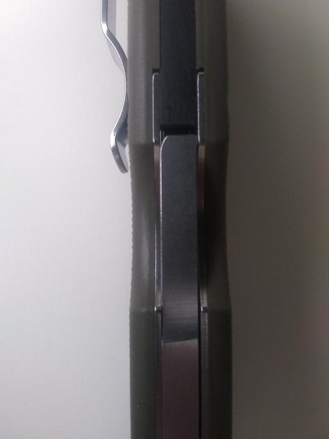

Yeah, the misground step in the lockbar. I had the same thing with an SR1. I returned the knife but not principally for that reason. I just wasn't a big fan.
I have a Talwar that also has that step slightly askew. Not as bad though.
I agree, it's sloppy.
I received my SR1 yesterday. No blade play, but the lockbar is just plain ugly. I know we cannot expect perfection at this price point, but...
I gave the SR1 another chance and bought the tanto version. The whole lock bar on mine is off center and even rubs the one side a bit. It’s sucks that the QC is so sloppy, but I liked the knife enough to just deal with it. There is really no substitute on the market for this type of knife in this price range so I have to give Cold Steel a little leeway, I suppose.
Yeah, I have some other CS knives where the step is crooked, but they were much cheaper and not as off as this SR1. I'm returning mine as well. :(
This example had a gap on one side of the lock bar too, I was trying to figure out if that was normal.
