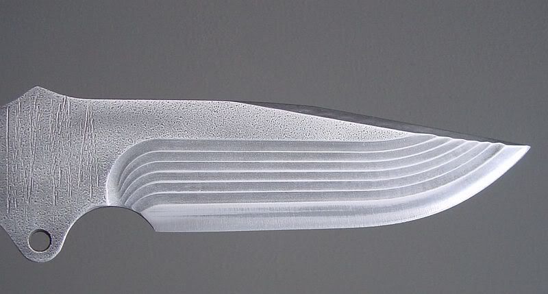

Sometimes even Busse enthusiasts have a hard time getting behind the more "irregular" marks sometimes randomly left behind in the CF process...like that subtle wormgroove above.
If I could have my "druthers," I also prefer to have more uniform and regular crosshatching on the flats of my CF models.
I am particularly fond of the vertical striations left behind in the primary grind behind the edge. :)
Still, IIRC at the time Jerry said he was dealing with <mostly> irate semi-pro zomby assassins who expected Competition Finish <despite the description> to be full-on high polish or satin finished blades. It wasn't only the irregular machining marks, but any marks in general on their blade faces that they weren't happy with. :confused:o_O
I'm just tickled piglet pink :p that Competition Finish has been resurrected-- even with the machining marks, regular or not! :D
