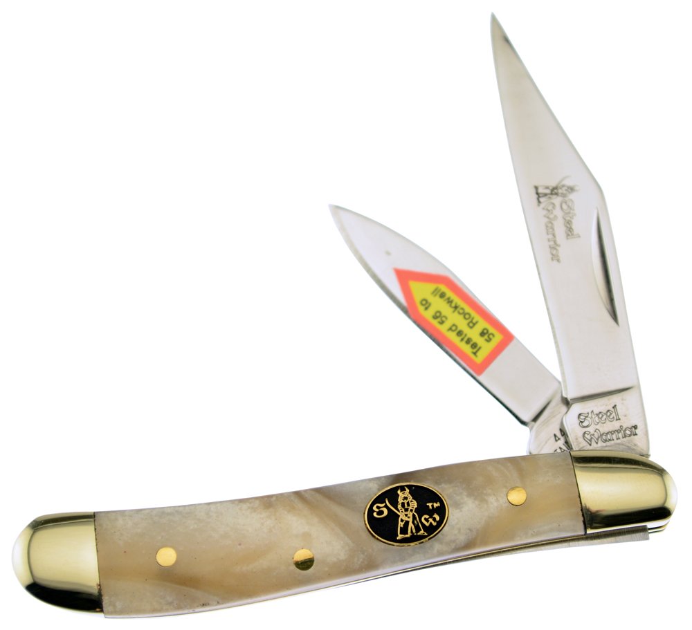

A dot and sticker on every knife!
Funny that you would post a Frost Cutlery knife. Certainly not high end. Although the Steel Warrior line has been said to be their better imported product line. I think they are all the same and cut from the same cloth if Chinese made.
Added: Frost doesn't even report what steel they use for the most part. :D
