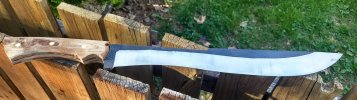

Competition Chopper M4, 3V, or Z-Wear

Yes, I did the heat treat. 1500, ramp to 1950, soak 30 minutes, plate quench, 2 hour temper at 1000 x 2
Have you guys tried the low temper with 4v? Nate the machinist says that the higher temper leaves a brittle edge! If I could find the time, I would like to test both methods, and share them here. I’m also thinking of trying a prequench, like Devin recommends for aeb-l, see if that adds any toughness. From what I understand, cryo is definitely mandatory with this steel.

I did not cryo, as it wasn't recommended in the crucible sheet, and I hit the RC I wanted without it. I think a little retained austinite in a blade like this could be beneficial.
The high temper does a pretty good job of converting the retained austenite. The advantage of LN/low temper is the prevention of the precipitation of the secondary carbides, which decrease free chromium (decreases corrosion resistance) and results in a slightly more brittle structure. With my z-wear test blades, I haven’t been able to damage the edge of either recipe but under extreme use, the difference might show.
So your saying, the low temper will have just a little less toughness? But probably better edge stability. Just curious, what’s the benefit of cryo, with the high temper, if your converting all the retained austenite with the high temper, and losing out on eta carbides? Possibly defeating the whole purpose?

Not worded quite right. High temper causes the precipitation, and slight decrease in toughness and corrosion resistance. Cryo/low temper prevents secondary carbide formation, which is slightly tougher and more corrosion resistant.
