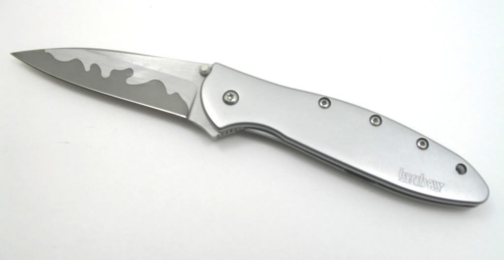

Basically what we are doing is taking two different steels and welding them together, thus making up the composite blade. Our future thought is to be able to offer up a blade that has a performance edge (CPM-D2, ZDP-189, etc...), and marry it up with economical, high machineability steel (13C26, 410...). Obviously your premium steel goes much further with this technology, and it will hopefully allow us to offset the performance vs. price issue that keeps many from ever using a higher end piece of steel. It should also play towards those steel snobs as well, plus it looks pretty cool.
Of course these steels need to be somewhat compatible when it comes to HT, as they are processed at the same time. Current strength testing is under way, but I don't feel is an issue.

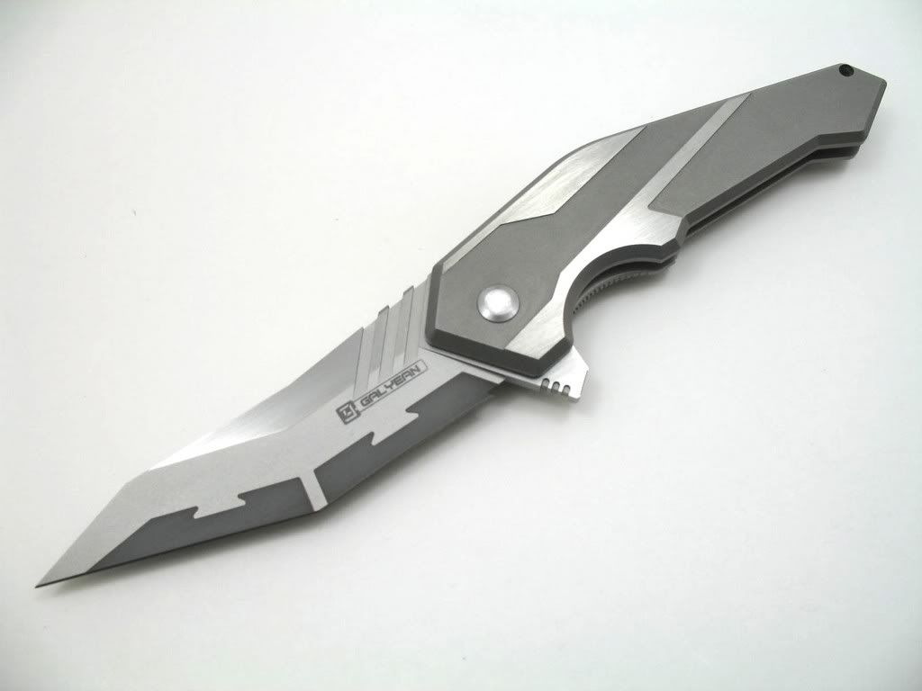

As for the welding, it can be done using either copper, nickel, or gold. We are testing different steel combinations as well as the actual ways that they can be affixed. You can see from the images Tif posted, the different ways we have done up some blades to date. The Leek is a 13C26/ZDP-189 blade, the other 2 are 154CM/CPM-D2 combo's. Ken's custom Tyrade is a 154CM/S30V arrangement. BTW, that is an image of Tim's new MOAB proto.

Tim, that is a awsome knife that you have designed! I can only imagine what it must be like to have something like that. what does MOAB mean?

Im glad you like it. Something quite a bit different for me design wise, but I like a lot of different styles of design.
MOAB means: Mother of All Blades.

you are welcome Tim. Kershaw going to put the Mother Of All Blades into production?

I'd be interested in the MOAB even if it wasn't made with a composite blade!
They all look great! Probably wouldn't take too much convincing for me to buy all three!
Hmmm...OK you convinced me, took less than I thought.
The MOAB is pretty wild looking. Are the dovetails in the blade, actually dovetails? Or are they just cut in that pattern to look like dovetails?

Laminated blades are in use for centuries and almost standard solution for knives in Scandinavia and Japan, but this is looks different because of "glue" you are using nicel, copper and gold. What is the difference between this and old laminated blades?
Only conсern I have - is copper rust easy?
