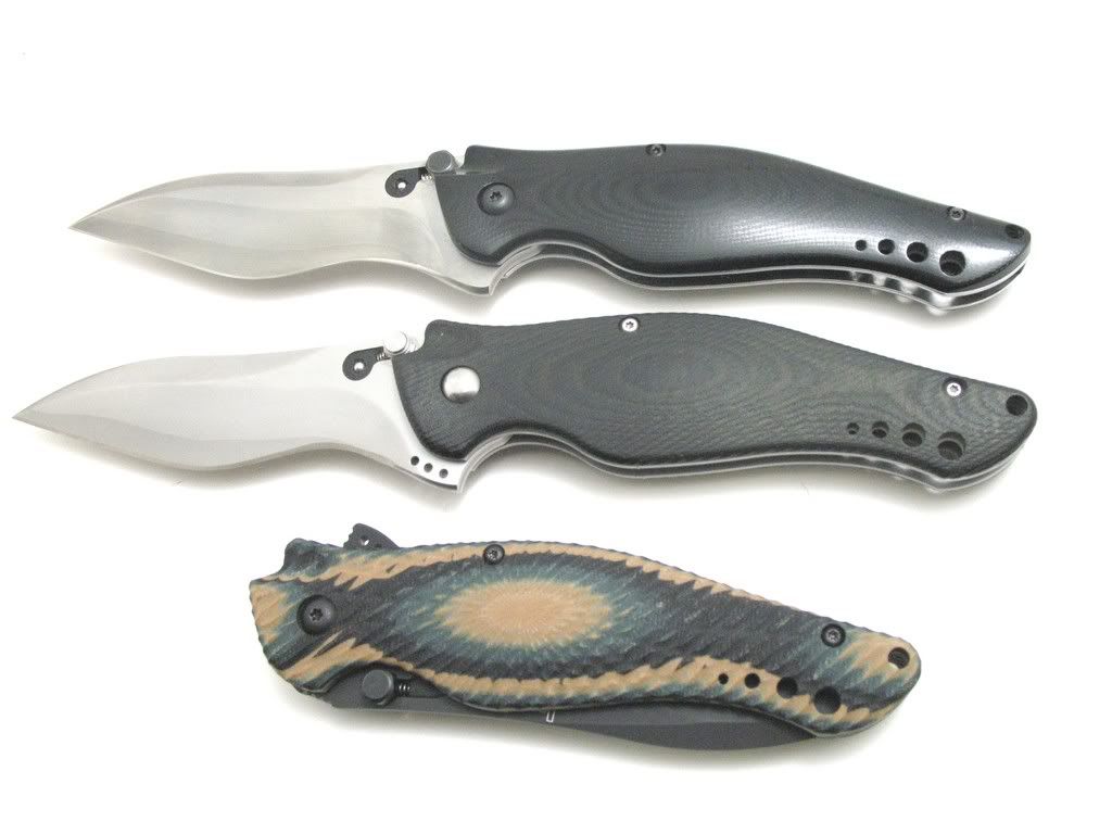

Hi all,
I thought I would expand a bit on the new composite blade (patent pending) that we put into the new Tyrade.
Basically what we are doing is taking two different steels and welding them together, thus making up the composite blade. Our future thought is to be able to offer up a blade that has a performance edge (CPM-D2, ZDP-189, etc...), and marry it up with economical, high machineability steel (13C26, 410...). Obviously your premium steel goes much further with this technology, and it will hopefully allow us to offset the performance vs. price issue that keeps many from ever using a higher end piece of steel. It should also play towards those steel snobs as well, plus it looks pretty cool.
Of course these steels need to be somewhat compatible when it comes to HT, as they are processed at the same time. Current strength testing is under way, but I don't feel is an issue.
As for the welding, it can be done using either copper, nickel, or gold. We are testing different steel combinations as well as the actual ways that they can be affixed. You can see from the images Tif posted, the different ways we have done up some blades to date. The Leek is a 13C26/ZDP-189 blade, the other 2 are 154CM/CPM-D2 combo's. Ken's custom Tyrade is a 154CM/S30V arrangement. BTW, that is an image of Tim's new MOAB proto.
The looks and combinations with these composite blades have seemingly unlimited possibilities and we can't wait to get into them.
We are pretty early in playing around with this technology, but feel it has potential to find a permanent place around here

P.S. Tim, is it MOAB blade is not just laminated but actually has two differen pieces ebeded for frond and end parts?
Vassili,
The MOAB blade is a Composite blade, so yes the two pieces are different parts. Laminated would be more like a sandwich.
