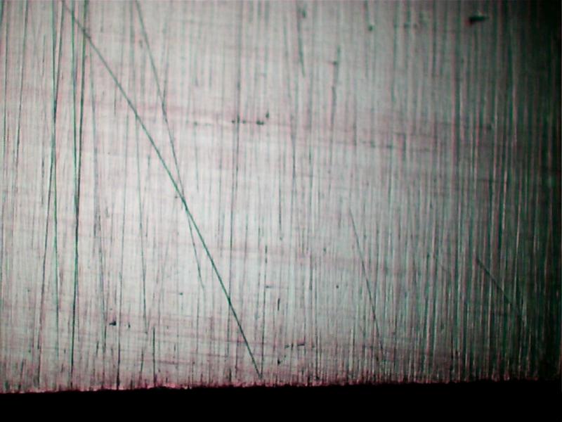

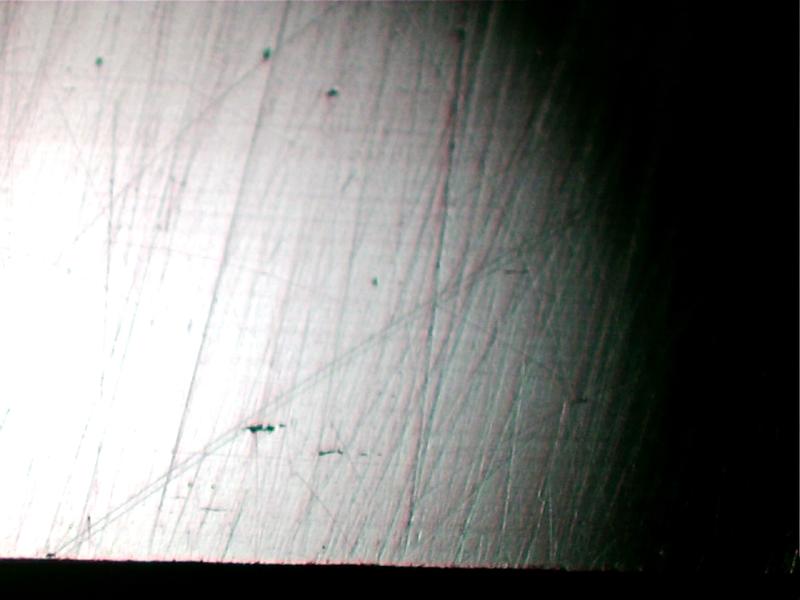

I just bought this used Spyderco UF in the German knife forum: https://translate.google.com/translate?hl=en&sl=auto&tl=en&u=http://kochmalscharf.freeforums.net/thread/1796/spyderco-uf
In this thread it is described how it was flattened with DMT 120 and then made finer with DMT 325, Atoma 600, (probably Naniwa 1000), Naniwa 5000, Naniwa 10000, lapping film and 0.5 micron diamond spray.
This is the edge the factory UF produced:
This is the edge it then produced:
The stone also got slower the finer it got.
I am now flattening the other side and will bring up to around 6000 (I think a little finer than regular UF) so it can be used before the finer side.
